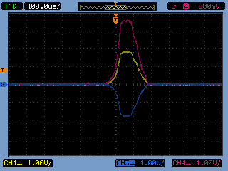

  • Hello Luke,
    With +/- 5V, this is the output we see from the amplifier.
    Ch4: Input (Pink)
    Ch1: Vo+ (Yellow)
    Ch3: Vo- (Blue)

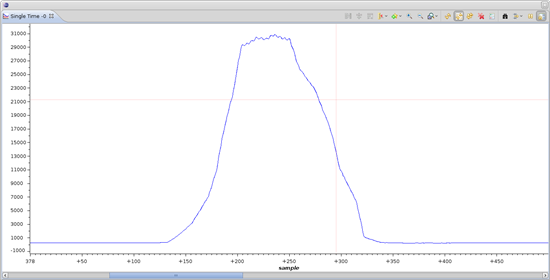

    ADC:
    Vo+ is connected to Ao+ and Vo- is connected to Ao-.
    ADC ref: 2.5V
    Vocm is not connected.
    The ADC values are shown in the plot below:
    Hope this helps.
    Basu
  • Basu,
    Vo- is swinging below 0V. If the ADC is only powered on 0V to 5V, this signal will be clipped and you will only see half of the signal. Try applying 2.5V to the Vocm pin of the amplifier and see if that helps.
    Luke Lapointe

  • Basu,
    The data converter is not seeing the signal on the Vo- because it is swinging below 0V. You need to add an offset to the output of the amplifier to center your signal in the middle of the ADC's range. If you apply 2.5V to the Vocm pin of the THS4130, then the output will be centered at 2.5V. For a 0-5V single ended input signal and a gain of 1, this would translate to a 0-5V differential output signal, or 0-2.5V on Vo- and 2.5V-5V on Vo+.This way, the ADC will be able to see both the positive and negative inputs from the amplifier and be able to use the full scale range of the data converter.
    Another thing to note is the input common mode range of the THS4130 is Vs- + 1V to Vs+ - 0.5V. This means that if your signal is 0V to 5V, you could be clipping the upper end if you are using a gain configuration of 1. You might want to adjust your supplies to give yourself some margin. For example, you could use Vs+ = 7.5V, Vs- = -2.5V. Another option would be to attenuate the input signal and use a gain to avoid this limitation as well.

  • Hi Luke -
    I'm working with Basu on this little problem here.  I think we've come to an understanding of what is happening - I'd just like to try to explain it here to make sure I'm looking at it correctly!
    (We are using Vs+ = 5V, Vs- = 0V, Vocm = 2.5V).
    The trick is how you look at a differential signal, and what it means to have a positive and negative differential signal.  We have an input signal that is single ended, has a range of 0 - 5V, and is referenced to GND.  When we use the THS4131 to convert this to a differential signal, we see Vo+ showing half the signal above Vocm and Vo- showing the other half of the signal inverted below Vocm.
    This means that we only ever see a positive differential signal, which shows up as a (positive) half scale result on the ADC (from 0 to +32768).
    What we should be seeing is the differential outputs flipping between positive and negative around Vocm as the input signal passes Vocm.  This would give us a differential signal that has both positive and negative values, and would give us the full range on our ADC (from -32768 to +32768).
    I'm not sure why it is behaving that way.  What we might do to solve the problem is leave the input as single ended and connect the ADC V- pin to the 2.5V reference.  This will result in the ADC seeing a differential signal that swings between -Ref to +Ref, and gives us a full scale digital result (-32768 to +32768).
    I hope that makes sense.  Thanks for your help.
