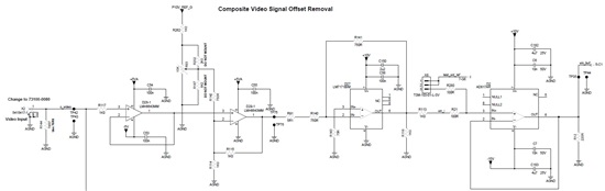

    Here I have a different query. Attached the circuit section which is part of a legacy design which I'm working on. We use LM7171BIM on the monochrome video path. During a recent review we noticed that 7171 is wrongly configured, but fortunately it was giving the proper output (not from a design perspective, but from the functional perspective).
    The video contains approx. +750mV DC offset (changes w.r.t camera) which we remove using R93 and D29-1. The D29-1 stage introduces a gain of +2.63 (measured). D27.6 gives a gain of +0.39. Why D27 gives a non-inverted output with gain 0.39? How it is functioning in this configuration? When I changed D27.4 from GND to -10V (now D27 works from -10V to +10V) D27.6 was giving a gain of  -1 (inverted), which is expected as per R141 (750R) and R140+R91 (750R+5R1).
    Can I keep 7171 same as in the circuit (0 to +10V)? Functionally it is OK, but how?
    Regards | Sinoj
  • Hi Sinoj,
    I've looked at your schematic and I believe D27 input is not biased properly with a single 10V supply. This might explain why you seem to measure a positive gain, instead of negative.
    R143 (75R) ties the non-inverting input of the LM7171 to ground and the input voltage range of this device requires about 1.5V headroom from either rail (1.5V to 8.5V range). So, you can switch to a device which has CM to ground capability (e.g. LMH6643), or you have to bias the input / supplies differently.
