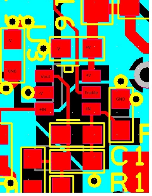

I am stumped.   I have an OPA355 ckt configued with gain=+2. Rf=499ohms, Vs=+/-2.5V.  I have done everything I can think of to minimize stray capacitance.  The amp has plenty of decoupling capacitance.
The Problem:
When I apply a 0.5V, 10Mhz square wave to the input, the output has a large overshoot (more than 50%); but only on the falling edge.  What could cause this asymmetry?
As an experiment I changed the gain to +1.  With a 499 ohm feedback resistor the overshoot remains but it disappears if I short across Rf.
  • Perhaps the asymmetry is in the amps output?
    If I place 5pf cap across the 499ohm Rf the overshoot is not noticeable; but this limits the theoretical frequency response to less than 100MHz which is not good enough.
    I believe I have a good layout; but maybe I have underestimated something.
    The symptoms are similar to excess capacitance on the inverting input. But there is no way I have 5pf of stray capacitance on the inverting input node.
    Is there an eval board for the OPA355 or at least documentation of the layout that was used to take the measurements in the datasheet? I couldn't find anything online.
    I have inserted my layout; maybe there is something I am missing?

  • Hi Paul,
    I understand the points you've raised and I agree with you. The scope return (ground lead) has fooled me with overshoot many times in the past, and that's why I prefer the coax to 50ohm scope termination for this kind of testing. But looks like you feel confident that's not the cause.
    Removing ground plane around / below the inverting input is also something to look at (although your layout does seem to be cleared off). Touching the scope tip to device pins would also tell you if you any of them is sensitive to capacitance and that could be a way to look for causes. If you had another device (different part number altogether but with similar speed), with similar pinout to drop-in, that could tell you more about your layout.
    As I said earlier, I'm not very familiar with this part's behavior.
    I'm hoping others more familiar in this forum would chime in.
    Hooman

  • This is definitely NOT an issue with the probe or the scope.  With nothing changed except the value of the feedback resistor (499 ohm vs 0 ohm) I can make the overshoot appear or disappear.
    I suppose it is possible that 75 ohms is not enough resistance to isolate the probe capacitance from the output -- but if that were the problem then reducing the gain would make the amp less stable not more stable.
    Perhaps if you explained your thinking regarding possible probe related issues?

  • Do you know what the capacitance is of the probe you are using?  Yes, I do suspect the probe could be causing measurement issues.  When we use probes in the lab we usually use high bandwidth FET probes with 1pF or less of capacitance.  For pulse response measurements we do not use probes at all.
    What else is attached to the amplifier output beyond the screen shot of your layou?  Can you easily disconnect it?
