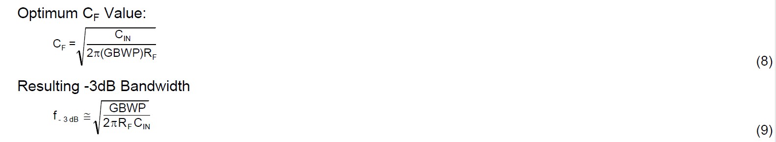

I am trying to design OPA657 transimpedance amplifier for input signal ranging from 5-40MHz.
In my earlier post mentioned in the below link, we were able to design a stable circuit for 17MHz signal using OPA 657.For 17Mhz, Feedback resistor Rf is 9.36k and feedback capacitor Cf is 1pF.
1) Is it possible to design OPA657 to work stable for a frequency ranging from 5MHz to 40MHz ?
2)How to check the stability of the op-amp at different frequency ?
Thanks in advance .
