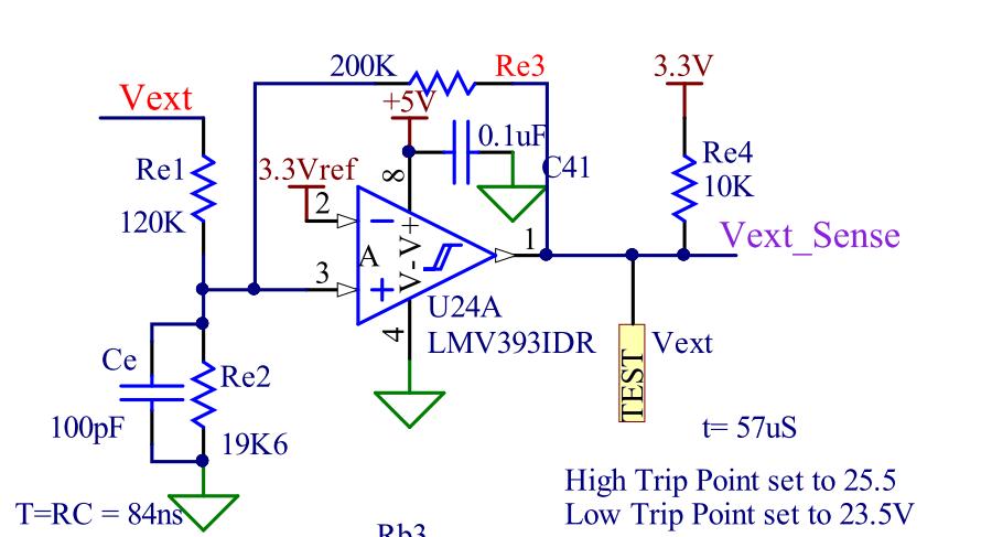

We have at least a couple LMV393 comparators on a prototype design where they appear damaged (at different times). We've chalked up the first to "maybe it got zapped" but a second time required further digging into really finding out why.   The only design "issue" we can figure is either its 5V power supply does some weird things on power on that eventually damaged it (unlikely), or that its because the input+ pin get voltage before the V+, eventually damaging it over time.  This pin gets about 3V (limited to ~ 230uA) for 30 milliseconds before the chip itself gets powered - every time the system gets turned on.
The datasheet only says max input  is Vcc+.   Thoughts anyone??

    Thanks for answering so quickly. Haven't a clue how "exactly" it was damaged; it was working for months and then... Can't seem to attach a schematic through the forum so a simple description:
    The input is monitoring the presence of a 28V power supply through a simple resistor divider where the comparator (with an external hysteresis) is to trip when 25.4V (on rise) and 23.5V (on fall). The IN- reference is set for 3.3V (LMV393 powered by 5V). At 28V IN+ should read about 3.8V but now it read about 3.1 (lower than the 3.3V IN-), indicating the input impedance somehow has dropped.

  • Hi Paul,
    Schematic inserted.  The Vext is the 28Vdc power mentioned earlier.  This can regularly be active about 30ms before the +5V is present.

  • Hi Dan,
    I do not see any immediate issues with the circuit. Although you are close to the common mode limit (3.5V) at room temp , and over it over temperature (3V). But that would not cause damage.
    The input has enough series resistance to limit the current to a safe level.
    What about the 3.3V ref line? Have you monitored it for any spikes? Is there any series resistance there?
    The inputs and output can handle transients up to 32V even without a power supply (the LM393 does NOT have ESD diodes on the I/O pins). But it really does not like voltages below ground since there is no controlled path (ESD diodes) for negative voltages and the current goes through the bottom of the die - and that CAN cause damage.
    The LM393 is a fairly tough device. I would look towards transients on the power supply and reference line, particularly transients below ground.
    Does anything else share the output line that could pull it below ground? Same for the reference line?
    Use a scope and watch the entire turn-on and turn-off sequence - and even wait a few seconds afterwards for "thumps", "chirping" switchers and other events that can happen as supply caps slowly discharge.
    Is the layout tight? Is tehre any "noisy' circuits near by (switchers, motor drivers, relays/coils, etc) that may radiate EMI or magnetic fields?
  • Dan,
    The problem I see is the hard short for the inverting input to 3.3V supply.
    The LMV358 would be greatly offended (high input current) if the 3.3V supply was higher then 5V supply at any time.
    Power up, power down, or supply fault.
