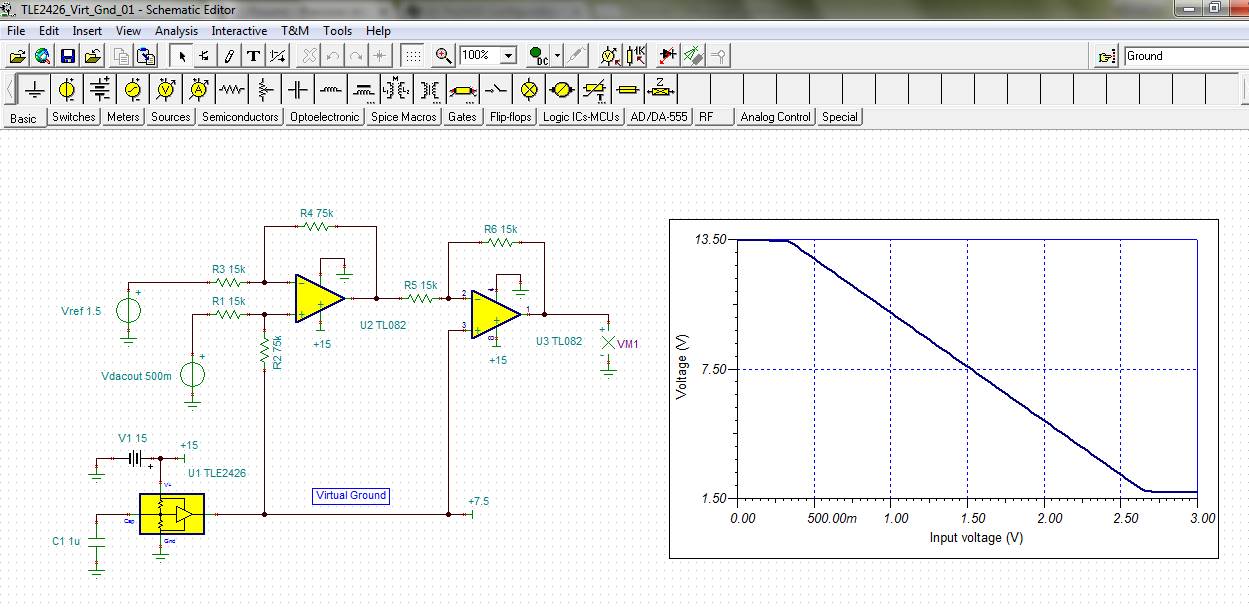

  • This is the circuit schematic that i ve made using TLE2426, please tell me whether it is right or wrong !
  • Hi Charles,
    The TLE2426 does not perform the function you are attempting to use it for. It is not capable of producing a positive and negative supply (+/-7.5 V) from a single positive supply (+15 V). Your circuit in the upper left will produce +15 V, +7.5 V and ground (0 V).
    Regards, Thomas
    PA - Linear Applications Engineering

  • Hi Charles,
    The TLE2426 is intended to create a virtual ground halfway between V+ and ground (0 V). In the case of your circuit you would have V+ at +15 V, the virtual ground at +7.5 V, and V- at 0 V. The +7.5 V/-7.5 V labeling in your schematic was confusing me about your expectation of the TLE2426.
    I have set your TLE2426/TL082 circuit up in TINA for simulation purposes. I do not know what your DAC output voltage is supposed to be so I just swept the voltage upwards from 0 V. You can see that the linear input range for your circuit is from about 0.35 V to 2.65 V. Voltages outside that range are limited by the output swing range of the TL082.
    You can use the attached TINA circuit if you would like to try different simulations.
    Regards, Thomas
    TLE2426_Virt_Gnd_01.TSC
