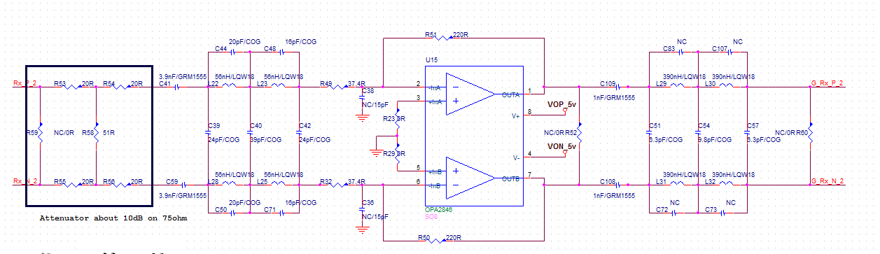

    THanks for the support.  Customer would temporarily be focused on OPA2836 at this moment.
    Can you help to review the schematics as below?
    Thanks!
    Antony
  • Hi Antony,
    I would suggest simulating this in TINA-TI to see what the frequency response will be like.
    I am wondering what R52 would be used for?
    Also, there is normally a termination resistor between the amplifier output pins (low impedance) and the filter input. These could be added between the amplifier output pins and C109 and C108. In addition to providing termination for the filter the resistors would prevent C51 from causing instability with the amplifier outputs. Most high speed amplifiers do not respond well to capacitive loads on the outputs.

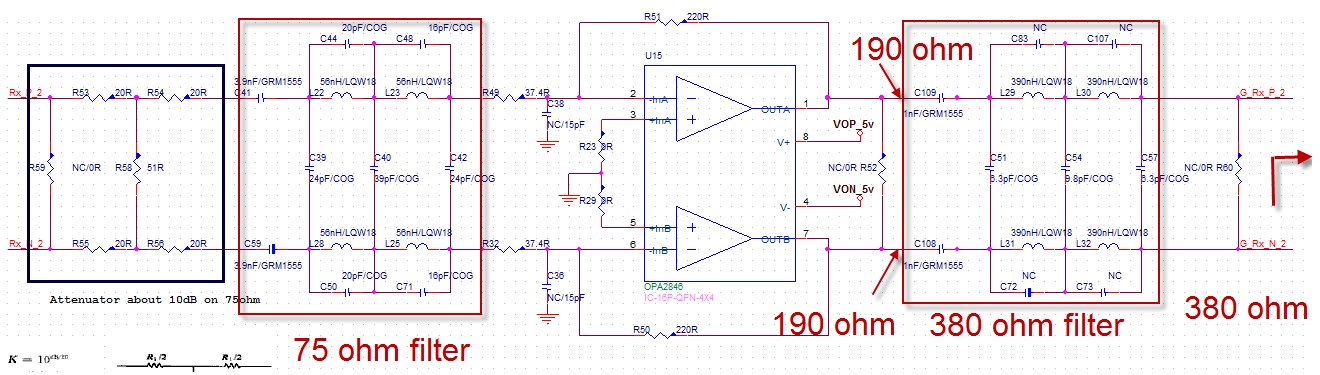

  • Hi Loren,
    Thanks fr your reply.
    As shown below, the input impedance is 380ohm.  Does customer still need to add 190ohm before C109/C108 for impedance matching?
    Thanks!
    Antony
  • Hi Antony,
    Unless the filter was specifically designed to have no termination, I would recommend the customer use the 190 Ohm resistors to properly terminate the filter.
    I would also recommend that the customer download our free TINA-TI software and simulate the circuit.
    Also, C51, C54 and C57 are fairly small (single digit pF). I would recommend that the customer try to estimate the PCB parasitic capacitances and include those in the simulation. It is common for a filter to have a frequency response that is about 10% lower than calculated when it is fabricated. One thing that helps mitigate this is to remove the ground and power planes directly underneath the filter components.
