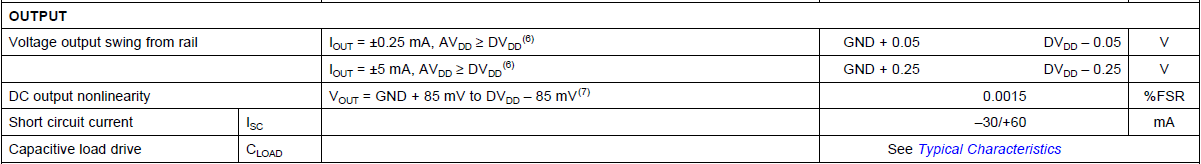

<1> Document issue
PGA112 datasheet ,page 36 table 9
I calculate the Maximum Signal by  Page 33   Vout = G x Vin -  AVdd /2 x(G -1).
I calculate the Max Signal and result is Vout =2 x 2.25 -3/2 x (2-1) = 3 V, Im confuse why document result is 2.95V.

  • Hello JD,
    The answer to your first question is that there is an Output Swing Limit of 50mV to the supply rails for the PGA112 (refer to page 7 of datasheet).  I have attached this specification below.
    Table 9 on page36, shows 2.95V because the supply voltage AVDD is 3V; which 2.95V is 50mV from the rail.
