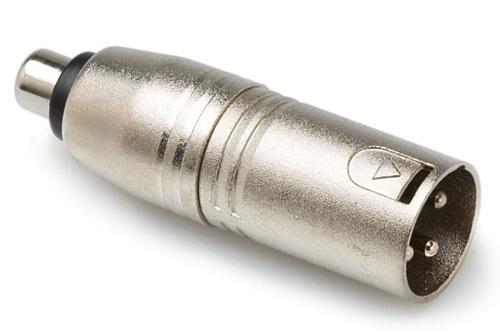

    It might be good to mention that I used an single ended connector like shown here: (since the pre-amp involved has an RCA output)
    So following your explanation it is apparently correct that I get the Vocm voltage at the OPA's input pins. Is there a way to work around this (without having to introduce a DC-blocking cap)?
