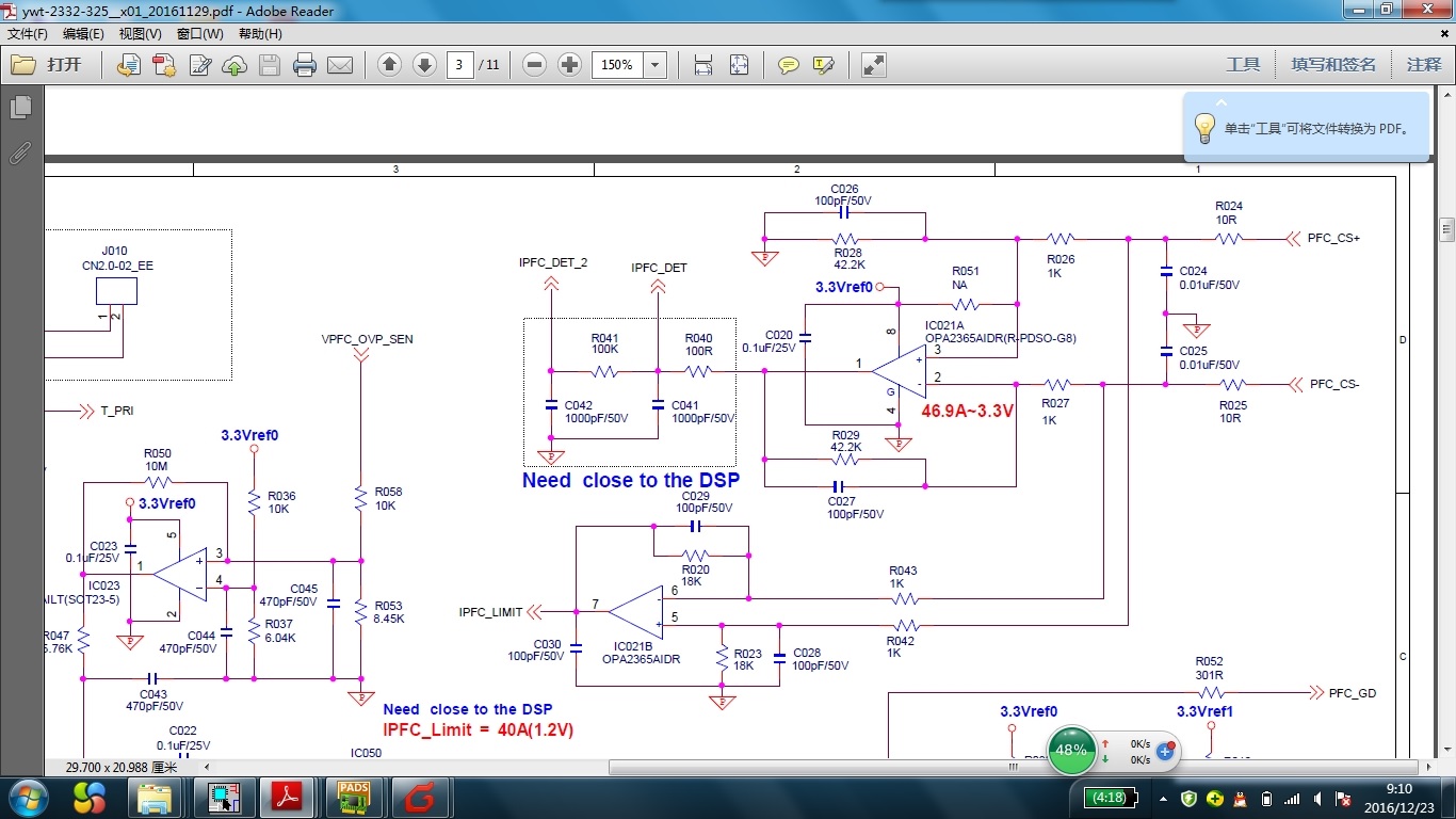

Hi:
    I am using OPA2365,Attachment is SCH!
    Output signal ( IPFC_DET)is  wrong,Can not enlarge the sampling current signal(PFC_CS+ &PFC_CS-).
    But I removed R042,R043, IPFC_DET is right!
    Could you give me some advice,Thank you!

  • Hello Feng,
    What is the IPFC_DET signal doing when R043 and R042 are installed? Is the IC021A output saturated to a power-supply rail or is it suffering from accuracy issues? If it is an accuracy issue, how large is the error? Providing a few measurement reading will be helpful to understand what effects the R043 and R042 resistors are having on the circuit performance.
    That said, the OPA365 will have over 30% overshoot with the 100pF load that's been placed directly on the output of IC021B. With R043 and R042 installed try removing this capacitor to see if the behavior improves.
