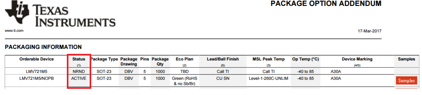

Our company has bought a lot of LMV721M5 on 2007. And recently bought the replacement one: LMV721M5/NOPB (Because LMV721M5 is about to obsolete).
Although the character in datasheet is completely the same, in actual test, we mounted LMV721M5 and LMV721M5/NOPB on the same place to the same board. The output is 3.28V with LMV721M5; While the output is 3.10V with LMV721M5/NOPB.
What might be the reason causing this different characters??? ((We have used different lot number of LMV721M5 and LMV721M5/NOPB to test, and it all get the same result. So We could exclude the possibility that cause by different lot))
