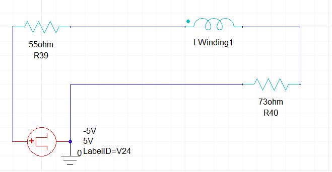

i want to develop a current sensor sample (which was used in motor control system, have high precision  ) with DRV401 ,  so a proper magnetic circuit should be chosen .
please see the figure as below, the material of probe core was FeNi alloy(80%Ni), it has high permeability. the size and airgap as below, and the number of  turns on the core was 300.
from the datasheet, i know a voltage 5V was applied on the probe circuit (please see the second figure, it was from the datasheet ) ,when the voltage 5V was applied on it , the probe
core will reach saturation in several μs, then the voltage will reverse and make the probe core to reach saturation on reverse direction, so if  there is no current to be test,  the probe coils will get
a 50% pwm. but in my magnetic circuit ,  i found a big problem:

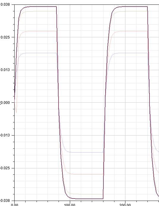

my question 1 was : when the 5V drive circuit applied on the probe core (size 5mmX1mmX1mm ,1j80 material,and 300 turns copper wire on it ), it will not reach saturation at all . please see my simulation (use ansys maxwell applied ±5V) result as figure 3,  the B at probe core should be 0.8T when saturated, but in my simulation, the result was about 0.037T. but in the datasheet ,when the current was 28mA, the probe core will be saturated .so why it can not get saturation and how can i get a proper probe core size?which size the probe core should be ?do you have any suggestions?
my question 2 was: the figure 4, it was from the datasheet.  when probe core got saturation, i think the current on coils should be (5V)/(55Ω+55Ω+18Ω)=39mA, but the document said it was 28mA when probe core got saturation, it conflict, and i am confused ,how to understand? can you give some explain?

  • Hello Jie Qian,
    Q1) I believe the probe is too thick and large in order to get saturated.  I am having issues simulating and I may need to adjust some things or redraw in order to simulate your design.  The smaller the probe the easier it will get saturated.  Once I get the simulation working on my system I will see what I come up with.
    Q2)The typical value is with many variation accounted for such as variation from device to device.  Your design should work at the minimum of 22mA and also at the maximum of 34mA.  Please note you need to account for the impedance of your probe coil and the probe material shifting.

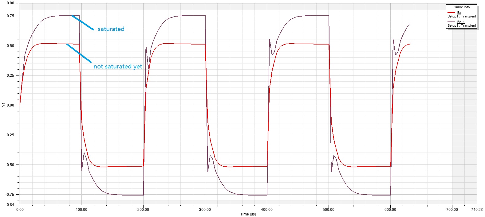

    Thank you very much for your suggestions, but i still want to solve the probe core not saturated  problem about the DRV401 application. and i change the probe core size to 0.4mm(length)X0.1mm (wide)X5mm(height). in my simulation it was saturated in the center point but still not saturated in the lower point, the entire probe core should be saturated? or just some parts? and why?. and the size of  probe core should be smaller ?and how about your simulation results?Thank you.
