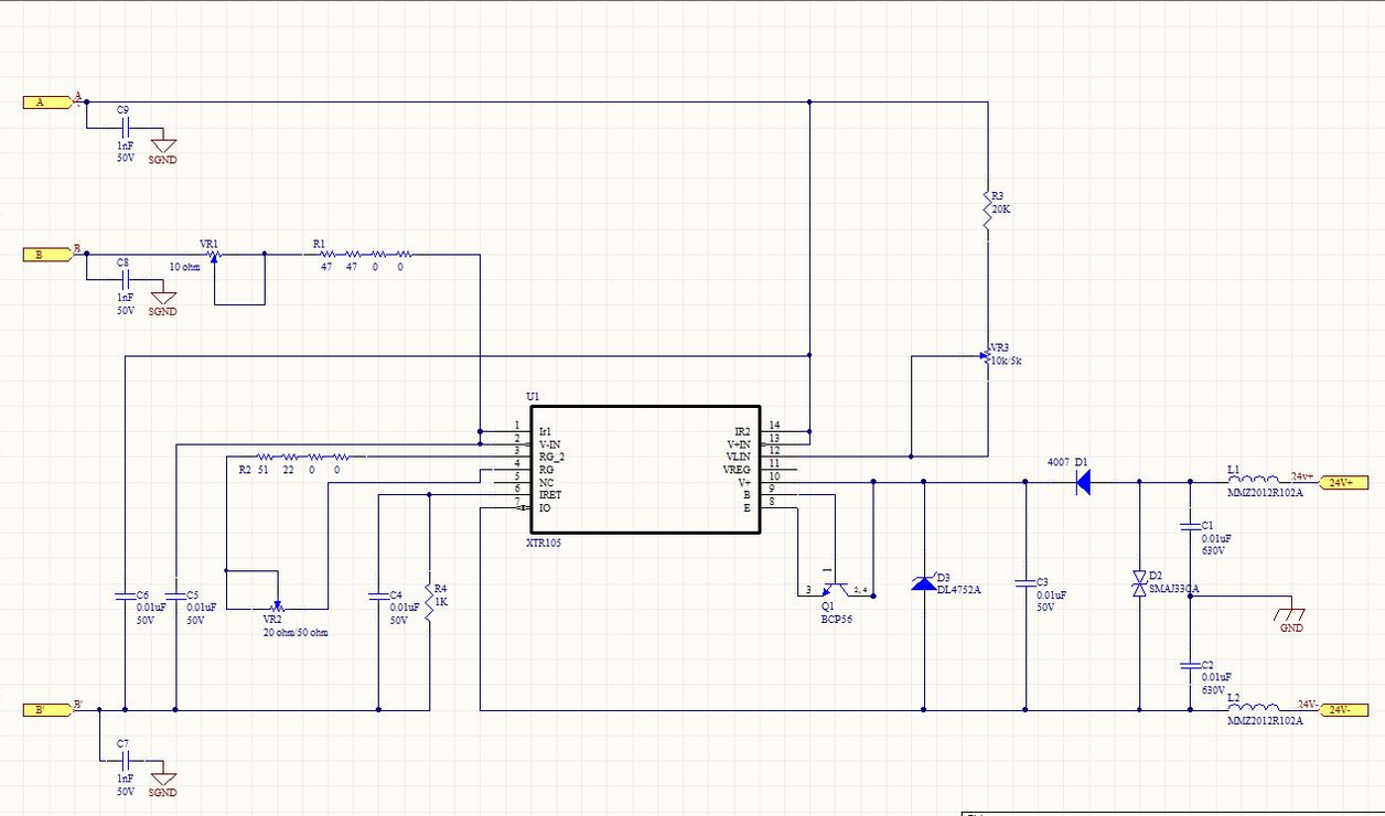

Hi team,
The customer is using XTR105. His schematic is in the attachment. His issue is as below:
When the input voltage is 0V, but the output current is 55mA that he measured. The normal current is 4mA when the input voltage is 0V
in his application.
Q1: Would you check the schematic if it is correct?
Q2: For the customer's issue. would you give me some suggestions?
