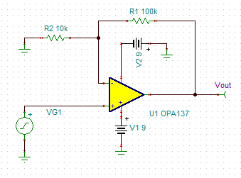

I am using OPA2137 in a non inverting configuration.  I have 10Koham in the negative input and 100Koham in the feedback for 11X amplification.  I am using +9V and -9V batteries to power the amplifier.  In order to test the setup I feed the positive input with a 100mV directly from a function generator at frequencies below 1kHz.  I feed both the output and the input signal from the function generator to the scope so I see them both simultaneously.
The output signal follows nicely the input, centered around 0, but there is no amplification.  In fact the output signal is 20-50 times smaller then the input (100mV).

    If I understand correct, your circuit looks something link this:
    Doing the simulation, we can see the transfer function looks like this:
    Which at 1kHz, is 20.83dB or linearly11.00 V/V .
    Looking at the transient with a peak to peak input of 10mV, I get close to 1Vpp on the output.Which is what we expect.

    Yes, this is the setup. To make sure it's not the scope I switched between the lines going into the scope. I see the same results.

    Everything is checked.  The wires are welded on a PCB and the device is in a metal box. The schematics is as shown by Bobby below.

  • I took the PCB out and rewired the whole thing. The wire connecting the output to the package was not good. It works fine now.
