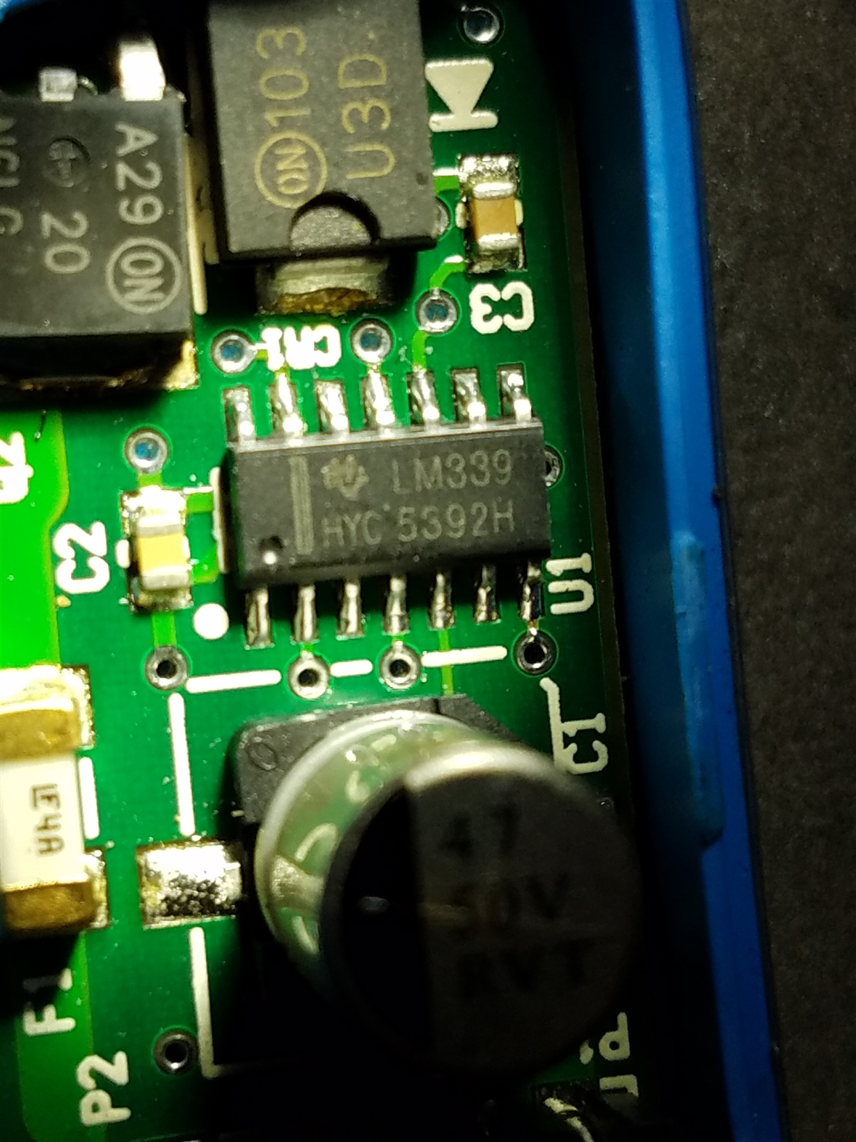

I am using an LM339 in conjunction with a 4401 transistor to control a FET.
I have started to see a rash of FET failures and have been able to make the circuit work and/or fail by changing the LM339.
The part markings on all the sample assemblies that fail are 'TI LM339' and  'HYC5392H'.
The markings on the sample assemblies that work are a mixture:
LM339 G4 and 9CADSVM
LM339 and 16P18NAG4
LM339 and 05P042AG3
LM339 G4 and 04ALFDM
What has changed?

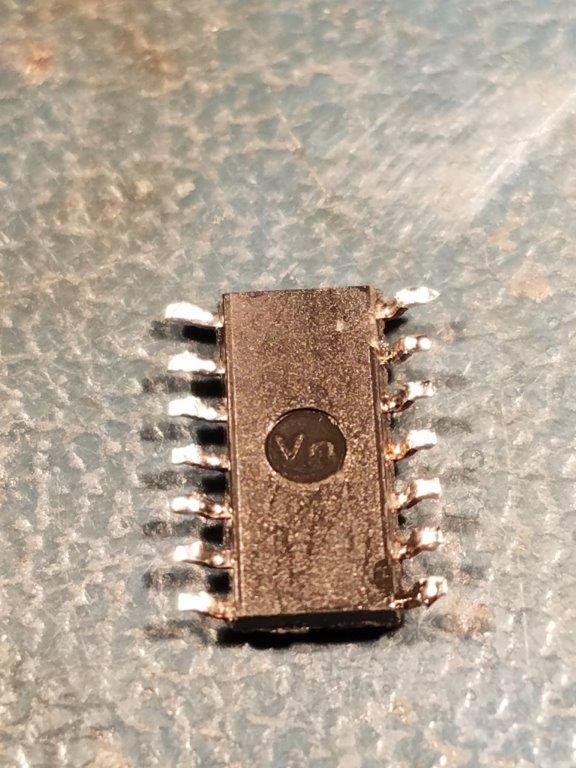

  • Hi Brian,
    Can you send a picture of the top and bottom of one of the "bad" device packages? Any maybe a picture of the label on their reel or box?
    The "Bad" units datecode does not make sense. The first two digits are the year and month, which should only run 0-9 and 0-9 & A-C. The last "H" digit also does not make sense.
    The "good" device datecodes seem correct.
    Where did you purchase the 'bad' devices? Do the markings on the "bad' devices look like the "good" devices? Same color/style font? Crooked?
  • The LM339 does not get damaged. Q2 overheats and fails (open). We can monitor and see the temperatures start to rise and shut down before failure occurs. We use this method to stop running before failure and then change the LM339. We can make a good assembly fail, and a failing assembly good, by swapping the LM339.
    These assemblies are built for us by Global Point in China, getting pic's of the reel may be difficult.
    Picture of top of failing LM339, blow-up of TI Logo, and bottom of IC attached.
  • Hello Brian,
    We are very suspicious about the "bad" unit. We would like you to send it in for analysis.
