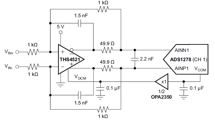

We need to drive ADS52J90. Input signal is 50Hz/60Hz +/-10V. I made the drive circuit refering ADS52J90 datasheet.
Can you review the circuit and advise me what can it be improved?
ADS52J90_drive_circuit.TSC
I select THS4524 for lower number of devices because ADS52J90 is 16ch.
DC connection is selected because not wanted to use large capacitance due to low frequency.
TLV376 is for common mode buffer from ADC.
I am not sure THS4524 works as 1/20 attenuator because min gain is 1V/V even though it works in simulation.
I am wondering if around fc=10k RC low-pass filter is added for better SNR.
