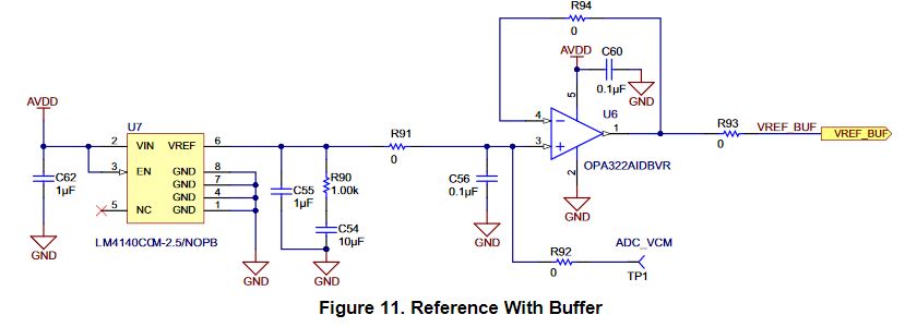

hello ,in article “Using fully differential op amps as attenuators, Part 3: Single-ended  unipolar input signals” ,there is a ciruit  which can balance the  common mode voltage offset?
But  I find  in design tida-00499 ,there is  another circuit ,the input  end which is not drive by signal  was only  a resistor R22 which act as Rs-,and there is no RT-,so i don't know if i use this  design ,how to calculate?
    In the above schematic, RG+ is R8 (487), RF is R7 (499) and R21 (499), RG- is R22 (523).
    Rs- and RT- are not shown in this schematic, because instead of a resistive voltage divider, a amplifier in a buffer configuration (gain = 1) is used for the reference voltage. It is not the exact same circuit.
