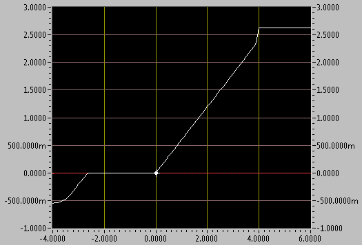

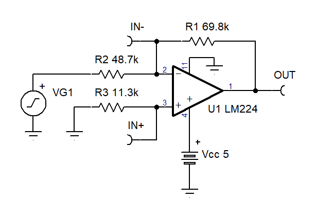

  • John,
    I tested the circuit you described and chose 5V for the power source. I also had to tweak the values to match my parts on hand.
    Here is my test schematic.
    Here is the DC transfer function VOUT vs. VIN of my setup. (bench data)
    Note that negative voltage gets the correct negative gain until output hits VOH level.
    For positive input voltage, the gain is small and positive based on VOL resistance.
    Eventually the sink driver can’t support the output current (from feedback) and the other LM244A sink driver takes over but it has a larger VOL headroom requirement.
    Here is IN+ (red) and IN- (white) voltage for the same VIN range. (bench data)
    IN- does violate input range, but only for voltage close to -3V or more negative.
    I tried input as large as -40V and output did not invert (on my sample).

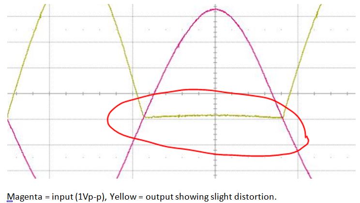

  • Hi Ron,
