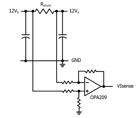

we notice that OPA209 would output 350mV under no 12V output condition
Brief schematic are shown below, would you please help to check about this?
CH1: 12Vb, CH2:12Va, CH3: VIsense

    is the OPA209 supplied by a single supply? Then you violate the common mode input voltage range when 12Vb is 0V. The input voltage must be 1.5V more positive than the negative supply rail.

    Kai's observation is indeed correct if a single V+ supply is being used. Please tell us what power supply levels are being provided to the OPA209 V+ and V- pins? Also, what are the values of the four resistors connected to the OPA209?

    The supply voltage on OPA209 is V+ = 18V, V- = GND

    There is a common-mode voltage (VCM) violation condition created when the OPA209 is operated with a single, +18 V supply and the 12 V supply is turned off. The Rshunt resistor nodes float under that condition and the 205 k resistor connected to the OPA209 non-inverting resistor pulls the inputs close to ground (0 V). It won't be exactly 0 V because of the input bias currents flowing through the resistor, but it will be close.
    The OPA209 lower end VCM limit is (V-) + 1.5 V, or +1.5 V because V- = 0 V. Pulling the inputs near 0 V and below +1.5 V violates this specification. Once the linear VCM range is exceeded the op amp output pulls up against an output swing limit. Since the OPA209 output is unloaded it will rest several hundred millivolts above the lower negative output rail (0 V).
    This can be corrected by adding a negative voltage of a few volts to the OPA209 V- pin; however, that isn't always practical or cost effective. Alternately, a rail-to-rail I/O op amp such as the OPA197 has a lower VCM limit of (V-) - 0.1 V, and the output when unloaded can move down to 25 mV, or less. Note that the output linearity is much degraded in the output saturation region and doesn't truly become linear until the output is several hundred millivolts above V- (0 V). That is the price to be paid if a V- supply can't be used.
