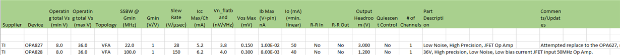

OPA627: Alternative device for OPA627
Part Number: OPA627
Other Parts Discussed in Thread: OPA827, OPA828
Hello experts,
I plan to use OPA627 for current follower circuit.
But it looks old device.
Is there alternative device for OPA627?
Thanks and best regards,
Ryo Akashi
