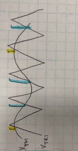

  I am trying to build a PWM generator using your comparator TLV3502 , with analog signal on one side and triangle generator feeding the other input
There is something I don't understand .
  The analog voltage and triangle voltage will cross at the same voltage ( + hysterisis  ). The problem is that  propagation speed at 1.2mV overdrive is very small. How can I increase the overdrive ?

    Sorry for the misunderstanding. We define overdrive as the amount of voltage your input signal exceeds your threshold voltage by. Take the example shown below where Vth is your analog signal and Vtri is your triangle wave generator.
    The highlighted spaces in yellow mark the periods of the triangle wave where the overdrive is very small. Lets assume in this case this overdrive is 1.2mV. However other sections (highlighted in blue) of the triangle wave have a much larger overdrive (>40mV). So if you were to DC bias your triangle wave higher, you would move out of this low overdrive range (Anything less than 20mV the propagation delay becomes highly variable).
    By DC biasing your triangle wave, you will get more consistent and accurate PWMing. If I am understanding your case currectly, just biasing your triangle wave by 50mV could get you much more consistent PWMing.
    Another suggestion would be to increase the amplitude of your triangle wave to increase the overdrive. Just be sure not to violate the device common mode in this case.
