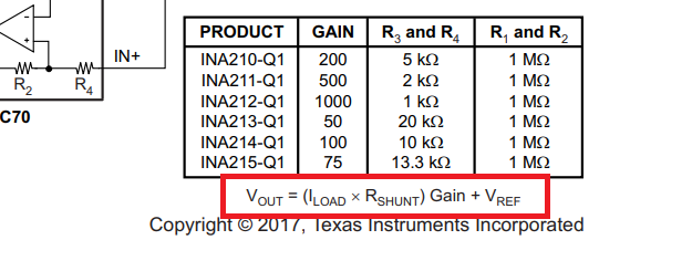

INA214-Q1:There are no input and output calculation formulas in the INA214A-Q1 data sheet.
Part Number: INA214-Q1
