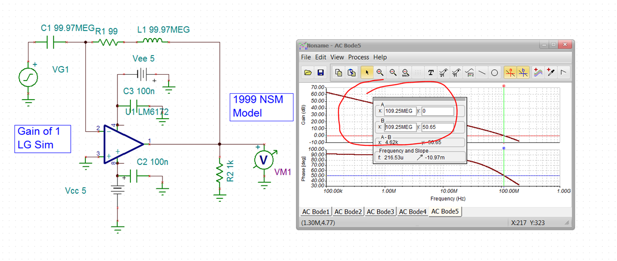

Hi Michael-san,
I just modified the schematic as follows, so could you please double-check it just in case ?
Kato
Looks good, I went on to closed loop gain of 1, the model does not match the data sheet at all,
The model looks transistor level, almost would trust it more than the PDS plots.
That 1.57dB peaking implies about 52deg phase margin from Figure 2 in this article - they broke the links to enlarge figures in this article, if you want the original PDF let me know
To run a LG for this gain of 1, would need to add the input C - not in the data sheet, but this lower phase margin at crossover obviously extends the closed loop BW by that about 1.6X in the latest article, The original Aol curve (not quite right for the gain of 1 as it is not including the input C) showed a unity gain of 109MHz with 50deg phase margin (again, this is missing the effect of the input C), which taking that times the 1.6X BW extension in that latest article predicts a closed loop F-3dB of about 174Mhz - pretty close to actual sim of 182MHz. The data sheet plots are way off on this, not sure what their errors are, but not uncommon on this kind of thing.

Datasheet vs TINA? Well, gain of 1 SSBW in the datasheet is very low vs simulation. I would be guessing they ran into a slew limit using too high a test output Vpp. I cannot be sure, perhaps the product group can run a SSBW test with 100mVpp output on the EVM board to get some guidance here.
One clue here, LM parts are done by the older precision group at NSM - LMH (Linear Monolithic High Speed) are done by more experienced high speed folks. LMH datasheets are usually a better, but not perfect either.
