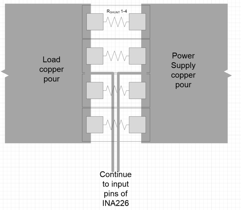

Our condition is in a high current sensing application, per considering the shunt resistor power dissipation, we may consider to use shunt resistors parallel for INA226-Q1 current sensing.
However, there should be more we need to take care of the layout or placement, is there TI's reference design for INA226-Q1 with using parallel shunt resistors for current sensing that could be for reference.
Or how should we do in this kind of application? Currently we may use 4 pcs shunt resistors parallel, and its output have 4 pcs MOSFET parallel with using LM5060.
