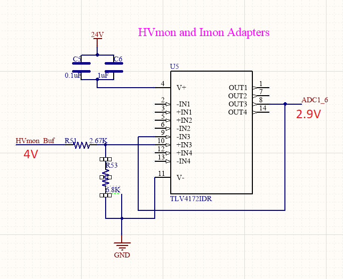

Hi Ti Community,
I am using TLV4172 Single-supply op amp to act as a voltage follower for my voltage divider and the results doesn't look as expected.
Based on the voltage divider formula, we have 2.7K/ (2.7K+6.8K)*4V =1.14 V output.
However, I measured the output signal to be 2.9V using both osciloscope and my multimeter. The resistor values were also measured with the multimeter.
Is there any particular design consideration when using a single-supply op amp of this type?
Thanks and please let me know if you need some clarification
