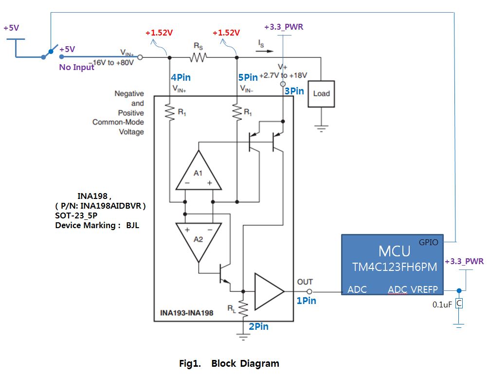

Hello.
I created a development board.
Unnecessary 1.52V is supplied to Load in [Fig1]  Block Diagram.
The input + 5V is not supplied.
Q1> Please explain why 1.52V is measured.
Q2> Is there a way to disable 1.52V output when no input voltage (+ 5V) is supplied?

  • Hello Kai,
    Fig1. This is Load in Block Diagram.
    And "Simplified Schematic" is described in the datasheet.
    Did you see the INA198 datasheet or post upper?
    Load is a device consuming current.
    Jame,Shin

  • Hi Jame,
    Javier is right. I wanted to know whether the input bias currents of INA198 have a chance to flow to ground. See figure 9 of datasheet.
    Without a low ohmic path to ground (through a low ohmic load, for instance !), the only path to ground might be the multimeter which you have connected to the inputs to measure the "unnecessary" voltage.
    Please connect for a test a 1k resistor from the Vin- pin to ground and measure again the voltage between the Vin- pin and ground.
    Kai

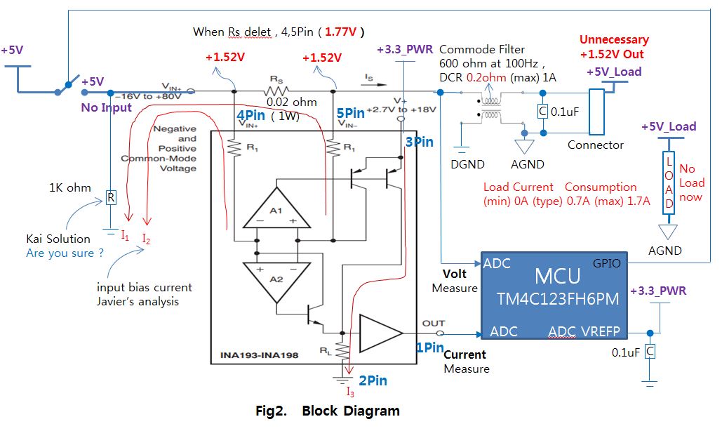

  • Hi Jame,
    I confirmed in the lab that there is a voltage on the inputs of the INA198 when it is powered and the inputs are floating.  I looked into it and there is the input bias current that needs to come from somewhere.  If floating it is biased to the voltages you saw I saw about 1.77V but I floated both inputs and no Rshunt was installed.  Depending on the load you have connected this will determine what current flows through the input pins.
    So the issue is the bias current at the input.  Figure 9 in the datasheet specifies the Input bias current vs VCM.  This is not really your condition because your VCM is floating and gets drawn to the 1.5V.

  • Hi Jame,
    I recommended the 1k resistor for a test. What voltage do you measure with this 1k resistor mounted? Still 1.52V?
    I would remove the common mode choke. Without adequate filtering cap or at least TVS on its left side the choke can produce huge voltage spikes (inductive kick back !) whenever you open the switch on the left. This can kill the INA198 and the MCU!
    To your third question: Yes, the INA198 (like any other amplifier) always needs a path to signal ground at its inputs. This can be a supply voltage, a regular load or a resistor as dummy load.

  • Hello Jame,
    The main issue is that when you are not forcing the voltage at the inputs they are still limited by the input structure of the INA198.  The INA198 will have the bias currents that it needs to satisfy to be in a working condition.  Normally there will be a something that can supply the 10µA to 100µA of input bias current and maintain a voltage either supply voltage or ground.
    For example if the switch was on the other side of your Rshunt then the Supply would be able to supply the µAs of current and the voltage would remain at the Supply voltage.
    If these are left floating the voltage will go to where the IB required is supplied.  If you have a resistor to GND then the bias current will flow through that resistor creating a voltage drop and creating a voltage.
