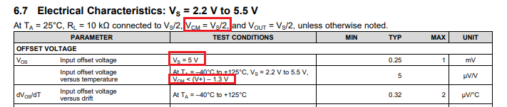

Hi there,
OPA2377-Q1 was used in one of our vehicle level project and we observed an abnormal Vos shifting. Hopefully we can get some support here.
Vos of OPA2377-Q1 was supposed to way less then 1mV according to datasheet.
  • V_tp223 = Vcc · R207 / (R207 + R203) = 3.75mV;
  • V_tp223 - V_tp226 ≤ 1mV (typical 0.25mV)
  • Gain_a = R202 / R201 = 66.7
And therefore V_tp227 is supposed to equal to 3.75mV * 66.7 = 250mV, and which it is, based on 5,000 samples test data.
However we found out one abnormal sample, V_tp227 = 255mV when first tested, and it changed to ~140mV after a couple of days without any operation.
And we tested some voltage level in this abnormal sample, which leads to an guess that Vos of this OPA was shifting somehow.
  • V_tp223 ≈ 3.7mV;
  • V_tp226 ≈ 2.1mV;
Can I get some professional opinion that what could cause this phenomenon? And how can we detect & prevent it.
