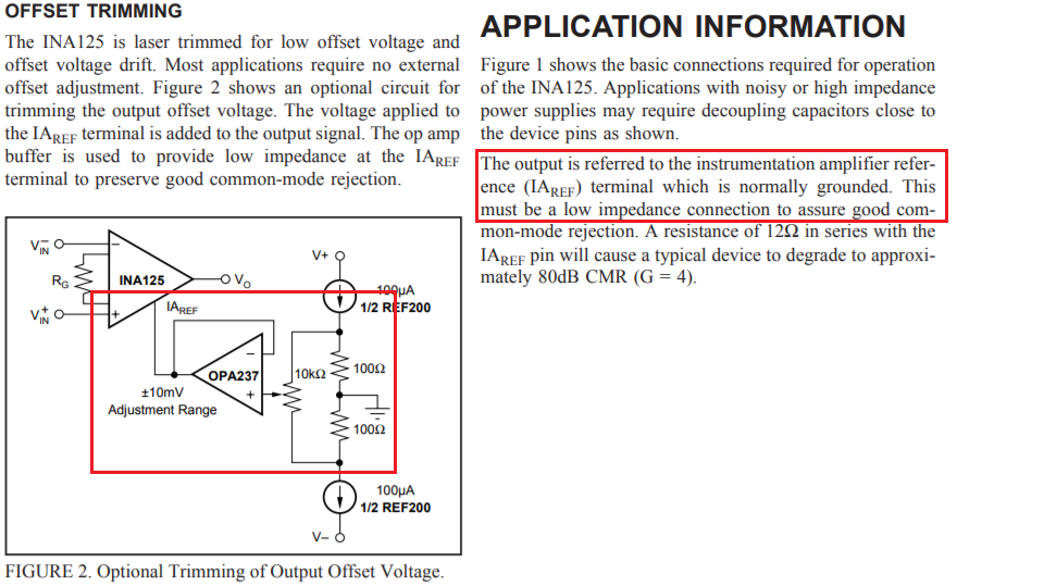

2-IIs it possible to connect the to use a potentiometer to change the input into the IAref pin 5 to set the initial bridge voltage with the required offset

    Question:
    Answer:
    IAref pin has to be stable low impedance voltage reference against temperature, noise and time in drift. If you want to use potentiometer, you have to connect the resistor divider through a voltage buffer. Output of voltage buffer will provide you with low impedance requirement. IAref pin is connected to 30kOhm trimmed resistor internally at V- point in A2, see the first page of the datasheet, see the attached image.
    Raymond
