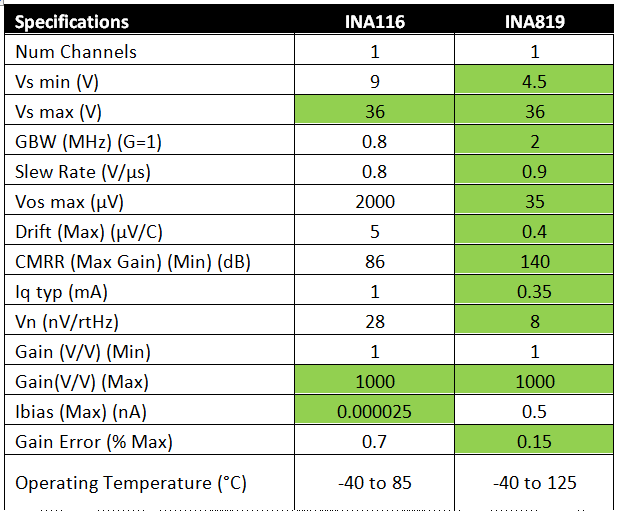

I note the INA116 is not for new designs, it has a wonderful input impedance and guard band drive, what is it's replacement?
Hi Relay,
Thank you for your question, I can help you. Take a look at the INA819: http://www.ti.com/lit/ds/symlink/ina819.pdf
