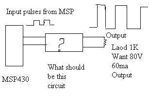

200us pulsating square wave genetared from MSP430 output port is to be amplify to 80Volts and 60 Amp to drive 1K load using 9V external Battery, Want circuit diagram
my input : square wave of pulse width 200micro second from MSP430 port.
Battery of 9V.
My output should be : Square wave of 80V  amplitude and 60mA current.

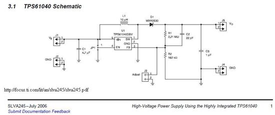

  • Q1) Is this circuit fine for boosting voltage problem?
                            This is 3v to 80V DC-DC boost converter (Ref: focus.ti.com)
    Q2) How i should convert output from above circuit (80V,5mA DC output)  to suare Pulses of 200us(80V, 60mA) which arrive after everty 20ms {. i.e. frequency of pulse waveform is  is 20HZ and width of each pulse is 200us}
