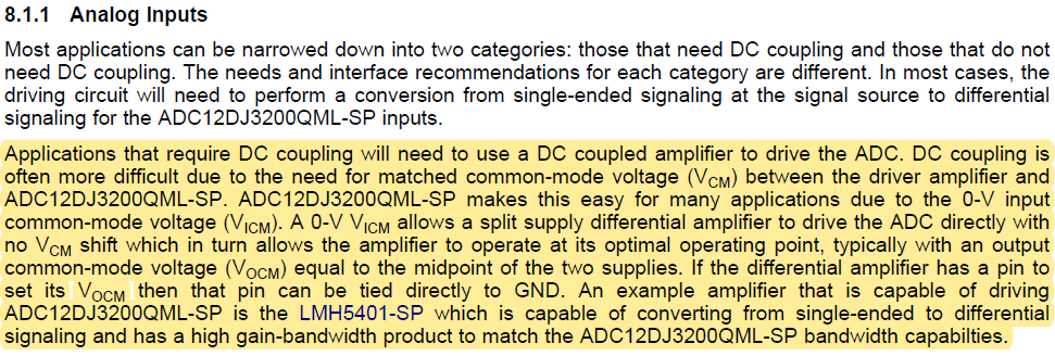

I'm wondering what your thoughts might be for a space-grade solution for generating a -2.5V rail for the LMH5401-SP. I have some flexibility in the input power. My main three options are 3.3V, 5V, and 12V.
My first thought is to use a space-grade hybrid module with a negative rail followed up with an LM137JAN-SP. The main issue I have with this solution is how large those hybrid modules are and their typical minimum voltage requirement can be higher than 12V.
What I'm now very much considering since we're still in the design/prototype stage, is to use a mixture of commercial and space-grade components. It would be a space-grade data converter, clock generator, and amplifier powered by a commercial reference design (TIDA-01027).
