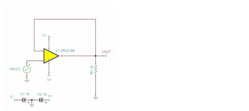

I want to konw the role of R1 resistor below voltage follower circuits which is in the ti precision labs lecture about slew rate.

The small signal BW response is set by the loop gain. That is influenced by the R1 through the open loop output impedance in the model. Typically, adding R1 like 1kohm will improve phase margin and make the response less overshoot prone
However, 1kohm load is also sometimes modeling the probe load and, since you say slew rate, small signal is not part of the issue.

Is the resistor misplaced. I believe it should be in series with one of the two inputs. Some op amps have input to input protection diodes. For these op amp, some series resistance is needed for the slew rate test. Slew rate test applies a large input difference voltage.

From what I can see from the first image, the role of the R1 resistor looks to be simulating a load impedance. In the real world, there is likely to be some sort of load. A 1kOhm load was probably chosen because it is not low enough to significantly affect the output stage. For example, if the load impedance is too low it will significantly load the output of the amplifier.

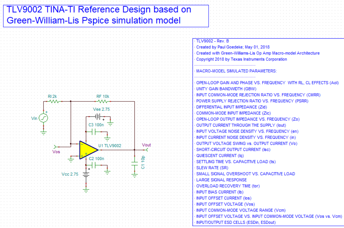

actually , I've checked reference circuits attached file.
That is simple voltage follower receiving PWM signal but R2 (10k) is connected inverting pin and I don't know exactly why it is connected.

The R2 resistor is useless. However, it does waste electricity. It slightly improves phase margin in an inefficient way.

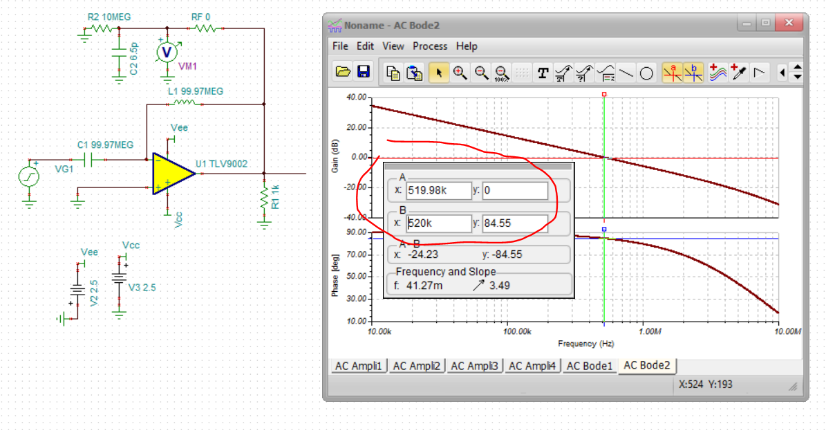

The loading gets into the response shapes through the open loop output impedance.Apparently, that is quite high on this part,
The unloaded unity gain LG plot is here, very good phase margin to begin with, 77deg with 1.1MHz xover
With a 1kohm load, the LG=0dB xover pulls way back and phase margin improves 85deg with 520kHz xover
That says the closed loop gain of 1 bandwidth should pull way back with the 1kohm load, and (at least in this model) it definitely does, Sometimes that 1kohm is intended to capture the attenuating measurement path out to a 50ohm cable - that looks like a series 976ohm to a 51.1 ohm shunt to ground then into the cable then to a 50ohm scope or network analyzer - big attenuation, but no line bounces.

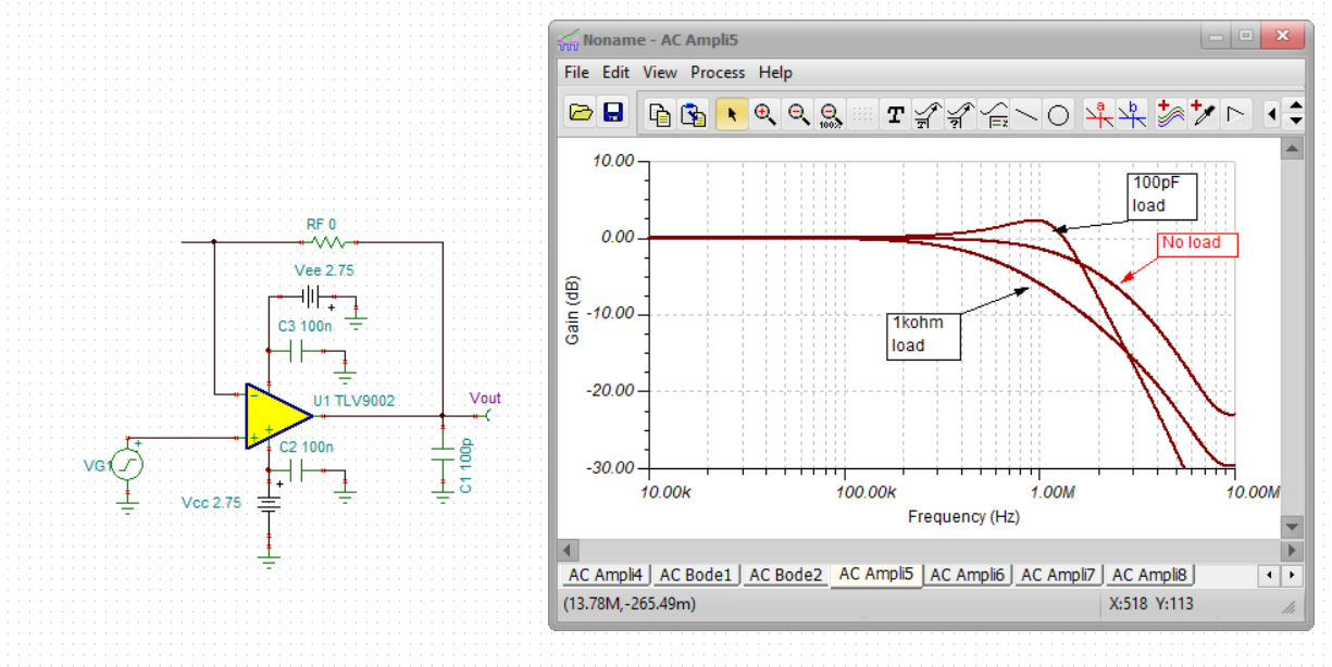

The other possibility for those cap loads you see in the reference designs and datasheet spec conditions is to extend the bandwidth by reducing phase margin - that is described in figure 4 of Insight #5,
Here is the gain of 1 TLV9002 sim with a 100pF cap load added, yes, quite a bit higher BW but peaking in this case,
