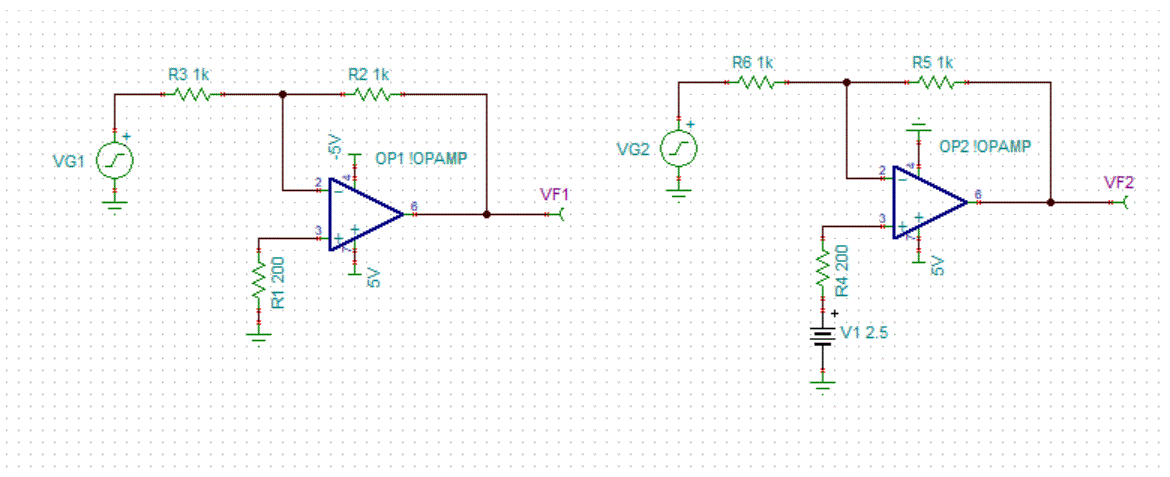

OPA698: Limiting amplifier with OPA698 unipolar +5V supply, Output limit 0-2V, inverting
Part Number: OPA698
I need to use OPA698 as limit amplifier for ADC input. Unipolar power supply +5V, Inverting input (0-0.8 V DC input signal). Output limit 0-2V.. That is the diagram, I'm using. Output voltage is always 1.1V and doesn't change with applied input voltage. Please, advice. Thanks
