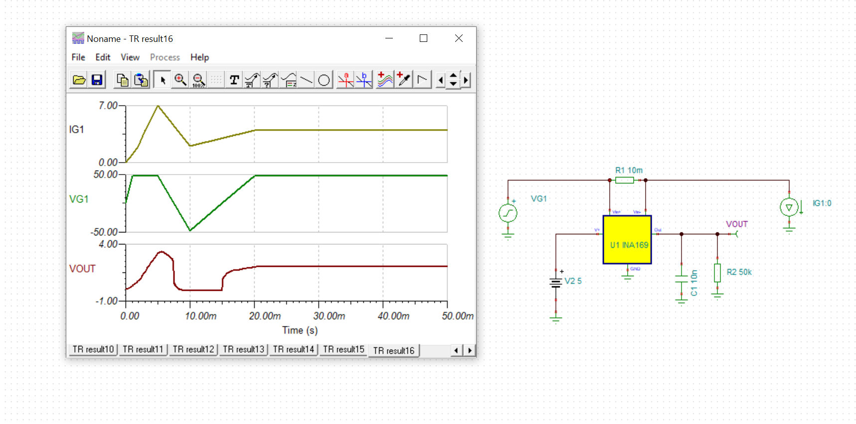

So I just want to measure the positive current of each phase for the BLDC motor[total 3 phases], so I tried to simulate it with the INA169 in software TINA.
I just cant get a good configuration , DC configuration works fine. BUT INVERTERING voltage makes it harder. The shunt resistor should measure till 7A.
I hope to hear from someone with instructions/solutions.
  • This is the way i tried:
  • Hello Okhan,
    The reason you are seeing the output drop to zero is because the VCM drops below the 2.7V at about 7.5ms.  The INA169 opeating VCM voltage is between 2.7V and 60V for its linear operating range.
    The absolute maximum is  -0.3V to 75V so going to -48V will not work with this device.
    I assume this is not the way it will be connected and the VCM will not go below GND.
  • Hello Javier,
    Thankyou for your reply, as you can see I try to get the inline method done. Is there any other way to do this better then what I got?
    I was thinking that maybe I just use this method with the focus on only measuring the positive VCM between 0-48Vdc( or 2.7Vdc till 48Vdc)....
    Maybe an important thing to remember is that the motor will also generate back emf so the current on the BLDC motor phase for example phase A will flow to both directions.
  • Hello Okhan,
    You may want to consider using the INA240 as it is bidirectional.  Or you can attempt using another bidirectional device.
