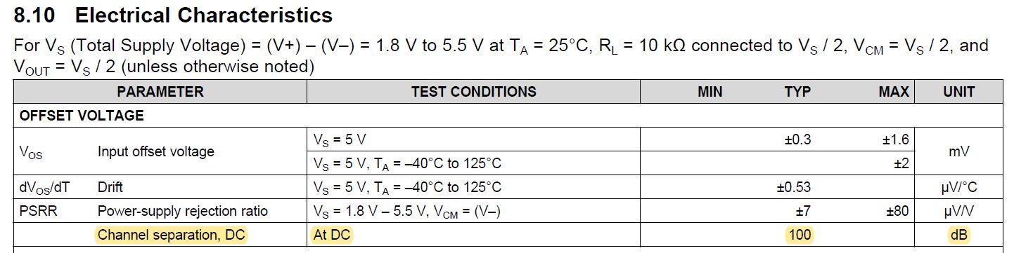

1. What's the meaning of "Channel separation, DC" in datasheet? You can also refer to below screenshot.

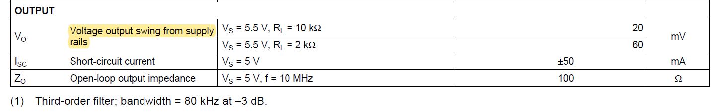

3. Does the voltage output swing from supply rails below regard to both V+ and V-?

  • Hi Daniel,
    For question 1 and 3, please see below attachments. You can also search in datasheet about the key words "Channel separation, DC" and " voltage output swing "
    2. Does the voltage output swing from supply rails below regard to both V+ and V-?
    Stanley

    Hello Stanley,
    Channel separation is a parameter used to determine how one channel affects another.  In other words, if the output of channel 1 changes, then the channel separation estimates how much you would expect channel 2 to change.  So if you have a 1V change at the output of channel 1, you would expect a typical 10uV change at the output of channel 2.
    For your second question the answer is "yes."  That specification is valid to both rails.
