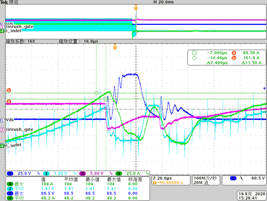

our customer is using our OPA192 as high side current sense. common mode voltage is 12V. They set the output current protection 75A. But when we test this current sense circuit.
If we step by step test and keep the static current stable, we can get the ideal result. Protection current is ~76A;
But if we test the inrush current or current transient, we found the protection current will go up to 90A. It is very dengerous for the whole system.
Could you help us analyse what lead to the protction current change?
CH2: Iin_det (Iinrush_det)
CH4: current
-Pengfei

    1. What are the VCCO and VCCO_RTN values?
    2. The graph details are not easily seen and interpreted. It would be helpful if more explanation could be provided regarding each DSO's trace meaning.

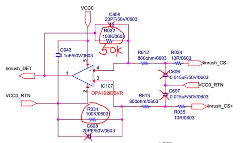

    3. Do you expect there is an issue with the way the OPA192 is functioning in the application? It looks like from the schematic that the maximum OPA192 output should be about close to 0 V for Ish = 0 Amps, 2.3 V for Ish ~ 75 Amps, and about 2.8 V for Ish ~ 90 Amps. The green DSO curve looks to be okay?

    1.VCCO=16V.   VCCO_RTN=GND. single end power supply;
    3. sense resistor is 0.000536 ohm. R612 R613 should be 808 ohm. So the real Gain is about 61.88. Their protection circuit design the protection point is 2.5V target to 75A. But real test result is 89A protection just as waveform shows.

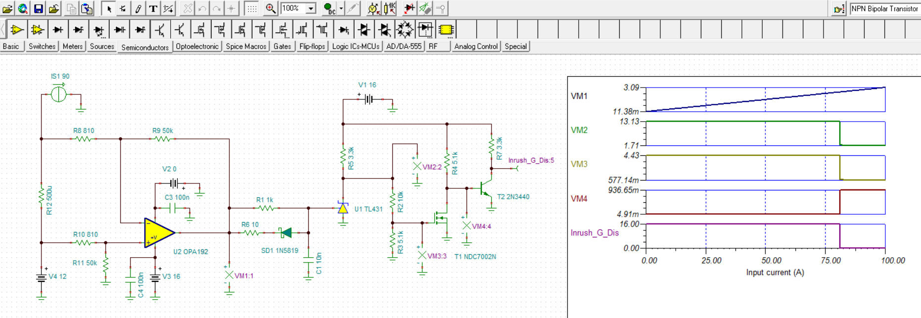

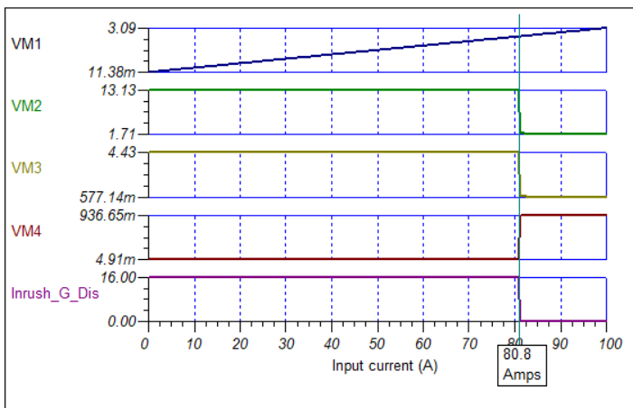

    The TINA dc or static simulation of the circuit shows the current trip occurs at about 80.8 Amperes:

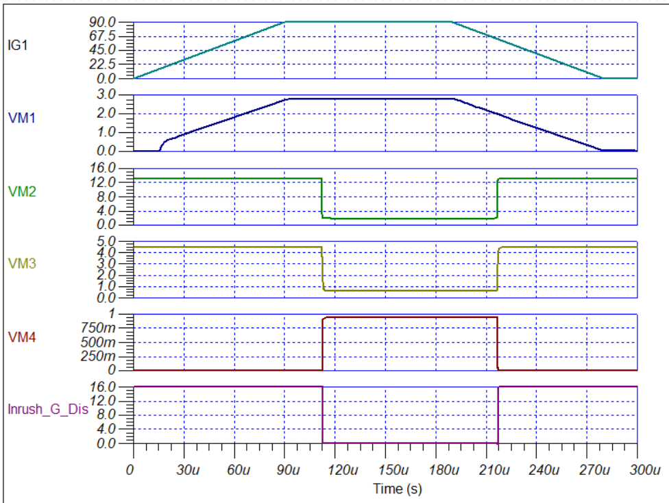

    I then set up the circuit for a 1 A/us current change through the shunt resistor. For a 90 Amp current step having a 1 A/us slew the duration would be 90 us. The results are as follows:
    I am confident of the OPA192 ac results and believe the transistors are good too, but I don't know enough about the TL431 results because it belongs to another TI division. Nevertheless, if the simulation is close there is about a 22 us delay after the input pulse reached 90 Amps until the output of the TLV431 (VM2) changes state. Then on the decreasing side of the current pulse there is a similar delay and the VM2 changes state when the input current drops to about 63 Amps. Hopefully, this is useful in helping you understand how the circuit functions.
    I am including my TINA simulation circuit for your examination. Note that the PBHV8115T simulation model I found on line does appear to be functioning correctly so I substituted another HV bipolar transistor at the output stage (2N3440). That should have very little effect on the overall simulation results.
