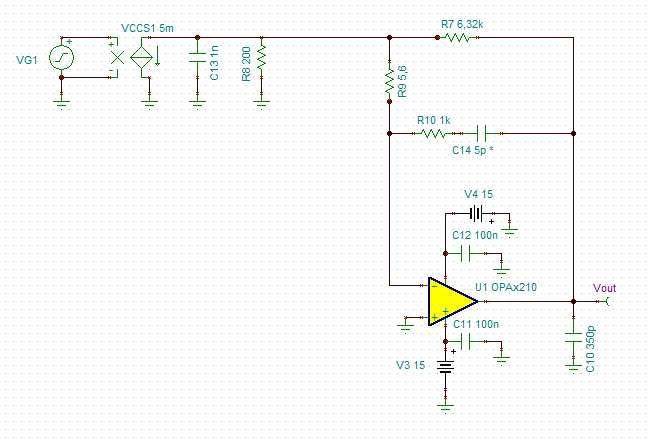

  • The right part is the amplifier and as the current noise times 200 is an order of magnitude less than the voltage noise paralleling could reduce overall noise, especially around 1Hz.
  • Hello Gerd,
    I took your basic OPA2210 TINA circuit and changed the input VCVS to an ac current source. Otherwise, the high voltage gain of the circuit caused the output to hit the rail. Then I ran an output noise simulation with one OPA2210, and a second with eight OPA2210 op amps wired directly in parallel. The noise sources in the simulation circuit are uncorrelated and as expected Neil's parallel op amp configuration results in an appreciable reduction in the output noise.
    Regards, Thomas
    Precision Amplifiers Applications Engineering

  • Hello Thomas,
    Yes, the output went into saturation because of the inout offset voltage of the amplifier.
    I took care of this by adding 5,00429uV DC to the voltage source controlling the VCCS (I think I could have modified the offset voltage in the OPA2210 model definition, but I just made a DC sweep and used the DC voltage where the op amp output was close to zero).
    Unfortunately the DC bias voltage of my VG1 source was not displayed in the schematic.
    I wonder how using an AC source prevented the op amps going into saturation, but it seems to have worked for your simulation.
    But wait. I did the above when I opened the feedback loop in order to measure the phase margin. With a closed loop, the input offset voltage of only one op amp should not saturate the output. Or was there a default 1V DC in the source you had used in the beginning?
    Anyway, so you can confirm that paralleling the op amps gives about a 2.5 fold noise reduction (in the flicker region, where the op amp noise greatly dominates the source resistor noise).
    Now the problem in real life is that I can neither AC couple the op amps (because I need the DC signal), nor can I set a DC offset to sub nanovolt precision individually for each of the paralleled op amps.
    You can simulate what happens in real world if you vary the input offset voltages of the 8 op amps individually.
    Gerd

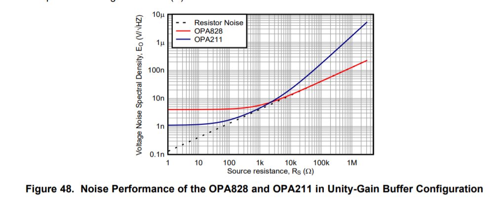

  • Hello Gerd,
    The OPA211 provides the best combination of lowest noise and wide bandwidth of our Precision Amplifiers op amp product line. It is a bipolar input op amp and its input bias current is higher than what is obtained with a JFET, or CMOS, input op amp. The latter types of op amps are most often applied in transimpedance amplifier (TIA) applications because of their very low input bias current, and the extremely light load they present to the input current source. However, that doesn't mean that bipolar input op amps can't be used for the application provided their higher input current is taken into consideration, and the load it presents to the input current source.
    You mentioned that the source impedance of your application is very low. If its output current is high relative to the OPA211 input current I think it will workout well in terms of a load on the source. Additionally, since the source impedance is low the OPA211 higher current noise which is higher compared to a JFET, or CMOS, input op amp should result in little additional noise voltage generation.
    The lowest noise, widest bandwidth precision JFET input op amp that we have is the OPA828. Its noise at 1 kHz is typically 4 nV/rtHz, with a 45 MHz gain-bandwidth. There is an interesting graph in the OPA828 datasheet comparing the OPA828 and OPA211 noise performance vs source impedance, in a unity gain buffer configuration. The JFET input OPA828 gives the bipolar input OPA211 a run for its money when the source impedance gets above a few kilohms.
    Regards, Thomas

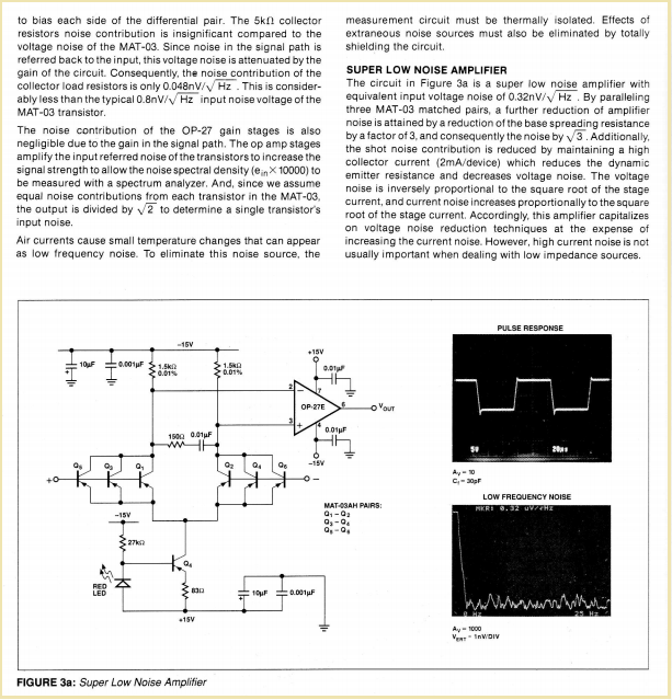

  • Hi Gerd,
    I think the OPA211 suggested by Thomas is an optimum solution.
    Maybe you can furtherly lower the noise a bit by using a composite design? I would give this circuit a try:
    Instead of the triple MAT-03, which is obsolete now, I would take two single MJE371 or another 3...4A Ic and 30...40V Uce small power PNP plastic transistor. These provide the lowest base resistances, important for lowest noise here. Buy some dozens of these transistors and hand select them for lowest noise. Also, play a bit with the collector current and supply voltage.
    Of course, some other designs could be checked as well. Here's a nice link:
    Uwe Beis is using an NPN design, though.
