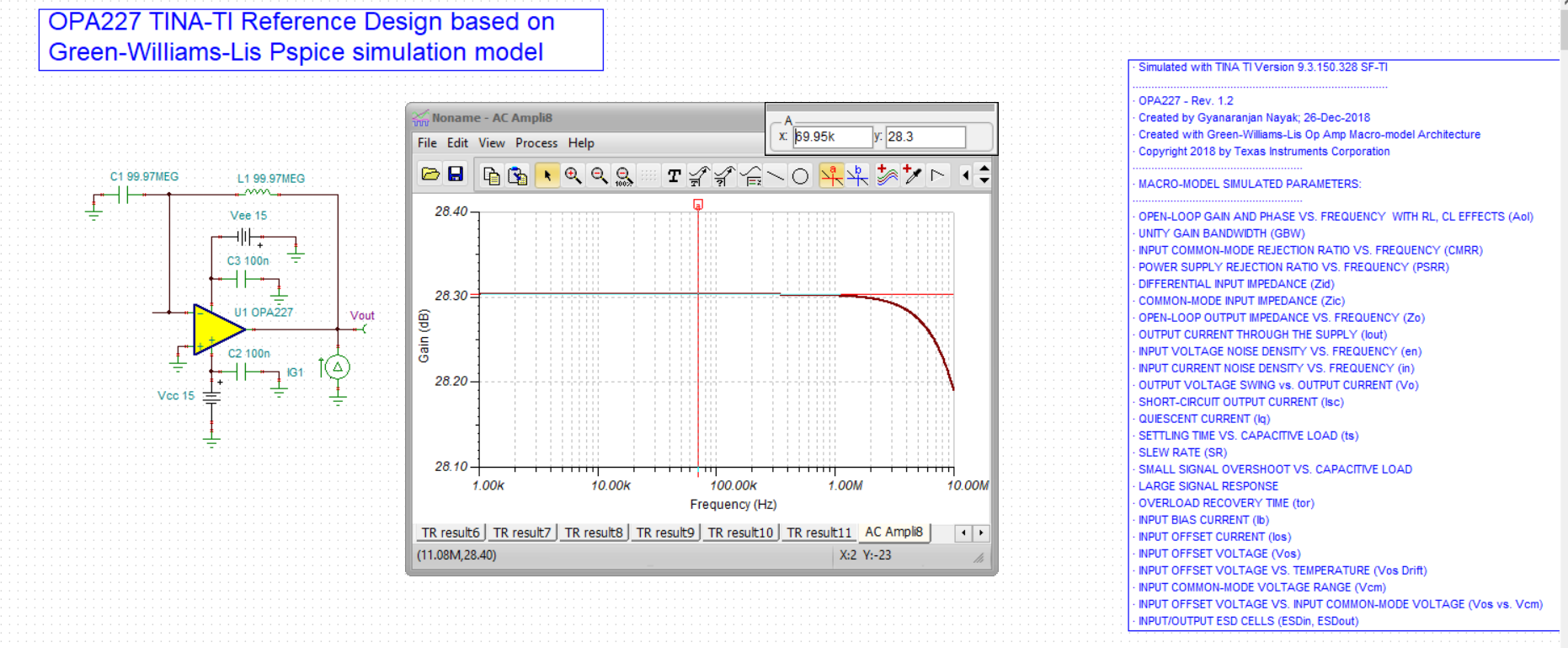

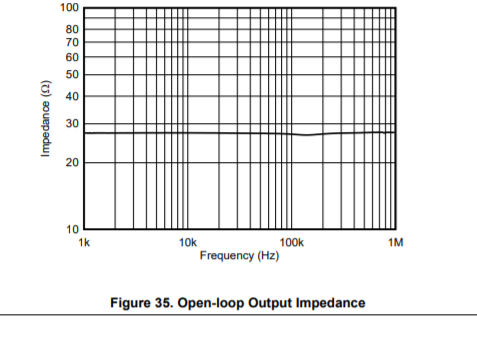

  • The closed loop output impedance is the open loop impedance divided by 1+loopgain. That loop gain will depend on the external ckt. This will simulate easily. The datasheet does show an open loop output impedance plot - I find its flatness over frequency questionable.
    And there was a model update in 2019, that one does simulate flat at 26ohms. Having done a number op amp output stages, that is kind of rare to be that constant.

    The open-loop gain is very high in this part. If loop gain is at 100dB at 10Hz, then the close loop output impedance at 10Hz is 26Ohm/(1 + 10^(100/20)) = 260 uohm.
