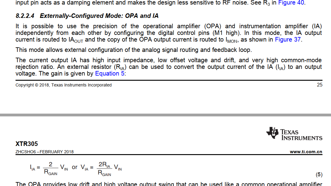

The formula on page 26 of the manual is as shown in the figure below.What is the accuracy of Via in the figure?

The accuracy of VIA will largely depend on the RIA and RGAIN resistor tolerances. For example, if you used 1% resistors, worst case RIA would be 1% high and RGAIN would be 1% low, which would lead to an error of 2%. The IA in the XTR305 has low offset voltage and drift. Page 8 of the XTR305 datasheet shows the Electrical Characteristics for the IA, including the offset error (typical 0.7mV) and gain error (typical 0.04%) of the IA. These errors will also be present the accuracy of VIA.
