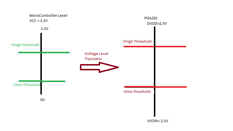

    Regarding the interactive gain, yes, I plan to use a microcontroller which would be at 3.3V. Thank you, I'd like to know which voltage level translator would be used. With this what I understand, would be to translate as shown in fig.1 (attached), from a scale of 0V-3.3V to a scale -2.5 to 2.5V, is that correct?
    But here I'm a bit confused. would you explain me what would be the specific range values for  Vhigh and Vlow levels in the scale of -2.5V to 2.5V?

    The logic high level and low level thresholds are defined on the datasheet below; where "DVDD" represents the difference between DVDD-VSON; and the absolute voltage needs to referred to VSON:
    Therefore, for the case VSON=-2.5V, and DVDD=+2.5V, the max logic low threshold:  VIL(max)=-2.5 + 0.2(5V) or VIL(max) = -1.5V
    and the min logic high threshold:  VIH (min) =-2.5 + 0.8(5V) or VIH (min) = +1.5V
    Regarding the voltage level translator, one possibility is to use a digital isolator such as ISO776x (or other similar solution)

    Regarding the level translation with a digital isolator, for example ISO7761, I think this would be something like the figure below, i.e, VCCI=3.3V GNDI=0V  and VCCO=2.5V and GNDO=-2.5V, with this the logic values for PGA281 will be correct. Is it correct the interpretation for the digital isolator?
    Thank you
    Jose
  • Hi Jose,
    This is correct.
    Thank you and Regards,
    Luis
