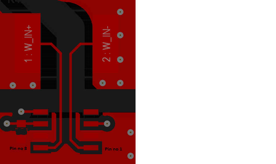

Our customer have placed the IN+/IN- connections underneath the device on their layout. They wanted to know if there are any issues with this and the ramifications? Below is the layout.
Thanks in advance!

Hey Art,
This should not be a significant problem, although would be better practice to avoid this and rotate the device 180 degrees.
Also, the NC pin should be connected to the GND plane.
