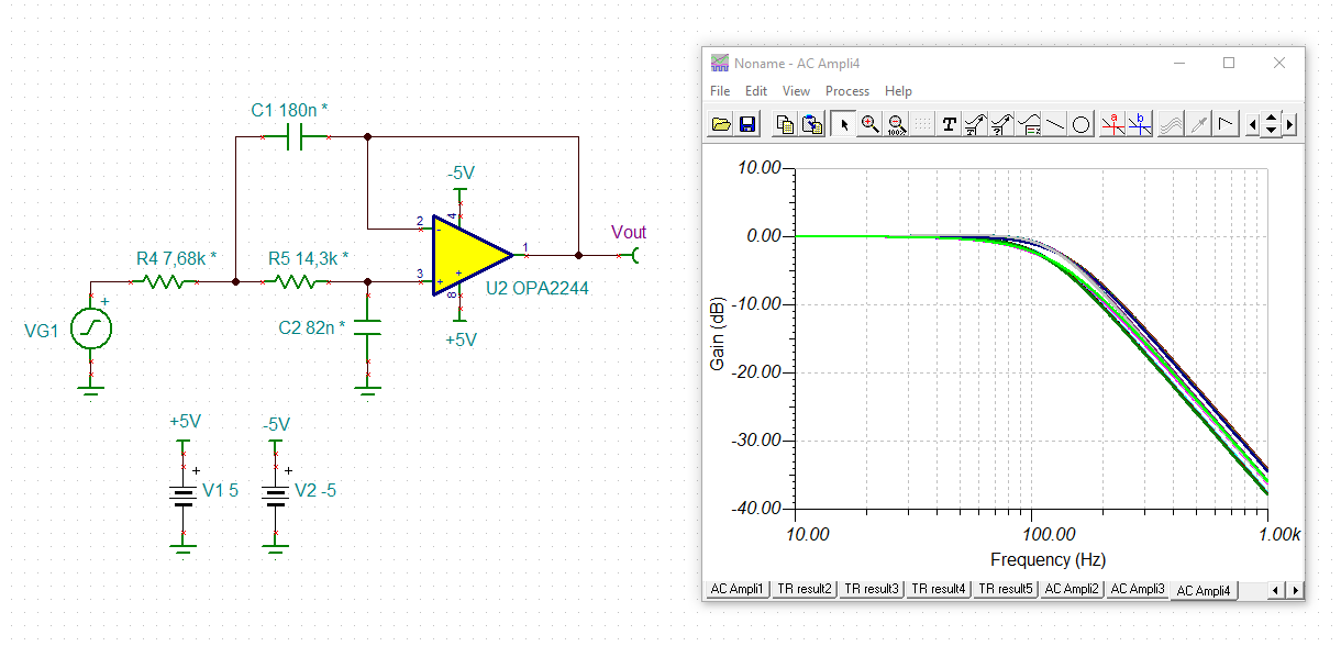

I’m testing a 2nd order Sallen-Key Butterworth lowpass filter. First configuration is set to have a 500Hz cutoff frequency. TINA-TI simulation and practical tests provide consistent results:
  • AC simulation shows a -3db attenuation at 500Hz
  • Transient simulation: 4.19V pkpk output for Vin = 6V pkpk input at 500Hz. (simulation file AAF_500Hz_tr.TSC).
  • Test bench: 4.2V pkpk output for Vin = 6V pkpk input at 500Hz.

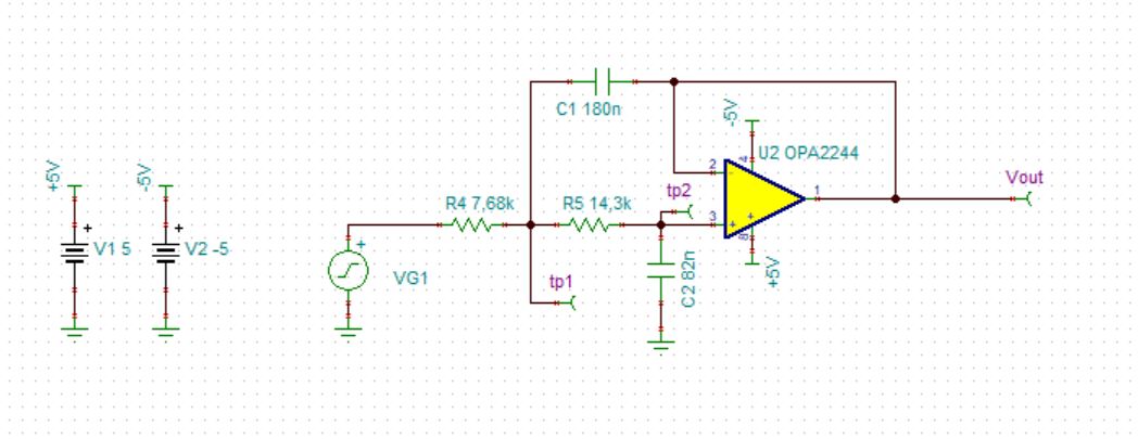

Then I updated resistors and capacitors values to have a 125Hz cutoff frequency.
  • AC simulation shows -3db attenuation at 125Hz
  • Transient simulation: 4.19V pkpk output for Vin = 6V pkpk input at 125Hz (simulation file AAF_125Hz_tr.TSC)
  • Test bench: 3.52V pkpk output for Vin = 6V pkpk input at 125Hz (same testing board).
I don't understand why there is additional attenuation in practice for the 125Hz configuration. Does anyone has already experienced a similar issue? Any advice would be very appreciated. Thank you.
Benoît

  • Hi Benoit,
    What tolerance of resistors and capacitors are you using? In simulation the component values are ideal but on the bench caps can have a 10% or worse tolerance which will effect the cut off frequency.
    Did you measure the input signal to the circuit to make sure that it is actually 6Vpp like you are expecting?
    Can you decrease your input signal frequency to 10Hz or at a lower frequency that is in the flat region of the filter and then increase the frequency until the amplitude begins to decrease? This will help determine where the circuit is beginning to roll off at.
    Lastly, do you have a gain/phase analyzer that you can use to see the gain of the circuit over frequency?

    « What tolerance of resistors and capacitors are you using? » I’m using 1% resistors and 10%. capacitors. If I used correct equations, by taking tolerances into consideration, attenuation should be in the range of [0.628 ; 0.794]. Attenuation I had in practice is about 0.587. Not sure it will help but I have ordered earlier today capacitors with a lower tolerance.

  • Hi Benoit,
    you can easily simulate the effect of manufacturing tolerances of filtering components in TINA-TI by using the "Select Control Object" method:
    benoit_opa2244.TSC
    Also take care, some ceramic dielectric materials are not well suited for active filtering circuits because their capacitance heavily depends on applied voltage:
    So only use class 1 ceramic caps (NP0). Another option is to use good plastic film caps (PS, PP, e.g.).
    I would not take +/-10% toleranced caps here, by the way, but only +/-5% or even better. Even +/-0.1% toleranced resistors are easily available today :-)

    • First table is the default configuration using X7R 10% capacitors for C1 and C2 (1% for resistors). This table shows Fc around 111,7Hz. Taking into account component tolerances, computed Fc range should be [112.52; 140.30] Hz. Lab result is slightly below this range but within Kai’s simulation results. I’ll review my excel sheet.
    • I have not received all the components yet but only 82nF COG 5% capacitor (C2). Second table shows results that are more consistent with simulations and computed data.
    So further to lab measurements and Kai’s answer it seems that I’m not having an issue with the OPA2244.... but I have to document myself on capacitor dielectric and secure capacitors specifications in production. Thanks again for your time and advice.

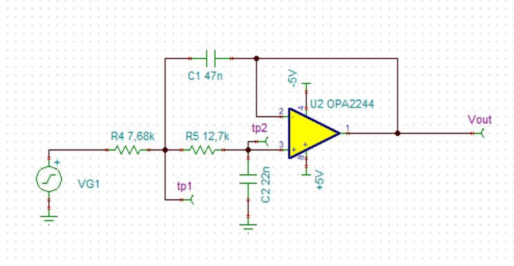

  • Hey Benoit, I was having a similar discussion on this thread. Each year, the cost comes down on higher precision C0G (NPO) dielectric MLCC caps to higher values. Once you start running monte-carlo's with even 5% C's, the results can be dissappointing. I basically default to 2% caps and 0.5% R's these days for any active filter design where higher Q stages need even better probably. An important point is the low cost ones are in the E24 and E96 steps, but at higher precision - that gets into a standard value fit optimization issue, but just a purchasing point here.
    If you care about nominal and over temp filter accuracy, C0G (also called NPO) dielectric has the best tempco and 2% in volume are sub .06 each up through 47nF it seems (today, that will go up in value range as time goes by).
  • Hi Benoit,
    you could modify the circuit to decrease the number of necessary precision cap types :-)
    benoit_opa2244_1.TSC
    Kai
  • Thanks for the link and information very helpful.
  • Thank you kai. This values open more flexibility in capacitor selection. I have ordered some parts and I'll test this configuration next week. I'll keep you informed.
  • Good luck on your testing!
  • I have tested the 19,1k / 47nF configuration in the lab and it works as expected. Thanks a lot to all for your advices on this subject.
