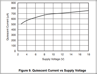

Also what's the current consumption for the V+?
    There is a spec for supply current consumption in the datasheet:
    In addition, it varies with supply voltage level:
    Unfortunately there is not s spec for REF1/2 current, however we can guesstimate. When tied together and driven by an external reference source, the total current consumed by the REF pins will vary depending on the reference voltage level (0V to 9V). But it should be below ±20uA.
