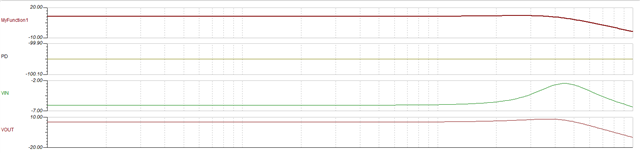

    My problem is that I can't get the results presented on the data sheet even with a TI-spice run on the EVM as delivered by TI for TINA. Here's what that looks like
    The 3 dB point is not 6GHZ!
    using their own sample for the EVM. So what am I missing?

  • Hi Ash,
    Your load is not 200 Ohms as the figure dictates. You are simulating 100 Ohms and comparing it to the 200 Ohms performance.
    You can see the correct bandwidth with a 200 Ohm differential load.
    Sam

    I'm missing something. The way you have it drawn the output load is 300 - 200 from R9 and R10, 80 from R6 and R7 and 10 ohms on each leg within the part. What am I missing?
    Also, I'm not sure what your cursor is showing at 6.01G. What is the 2.03 value?
