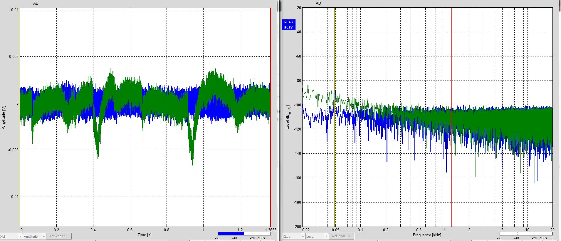

I began to investigate the noise issue and found that there are audible low frequency pop sound which look like short signal jumps in the time domain.
See attached picture for the measurement:
As you can see, blue channel is fine, green channel has pop-noise. We nearly tried everything to find the issue. I can exclude the following things:

    1. The PGA seems to cause the random issues shown in the above picture. These occur without any (recognizable) influence to the circuit. This pop sound is best audible when HF noise is removed with a LPF.

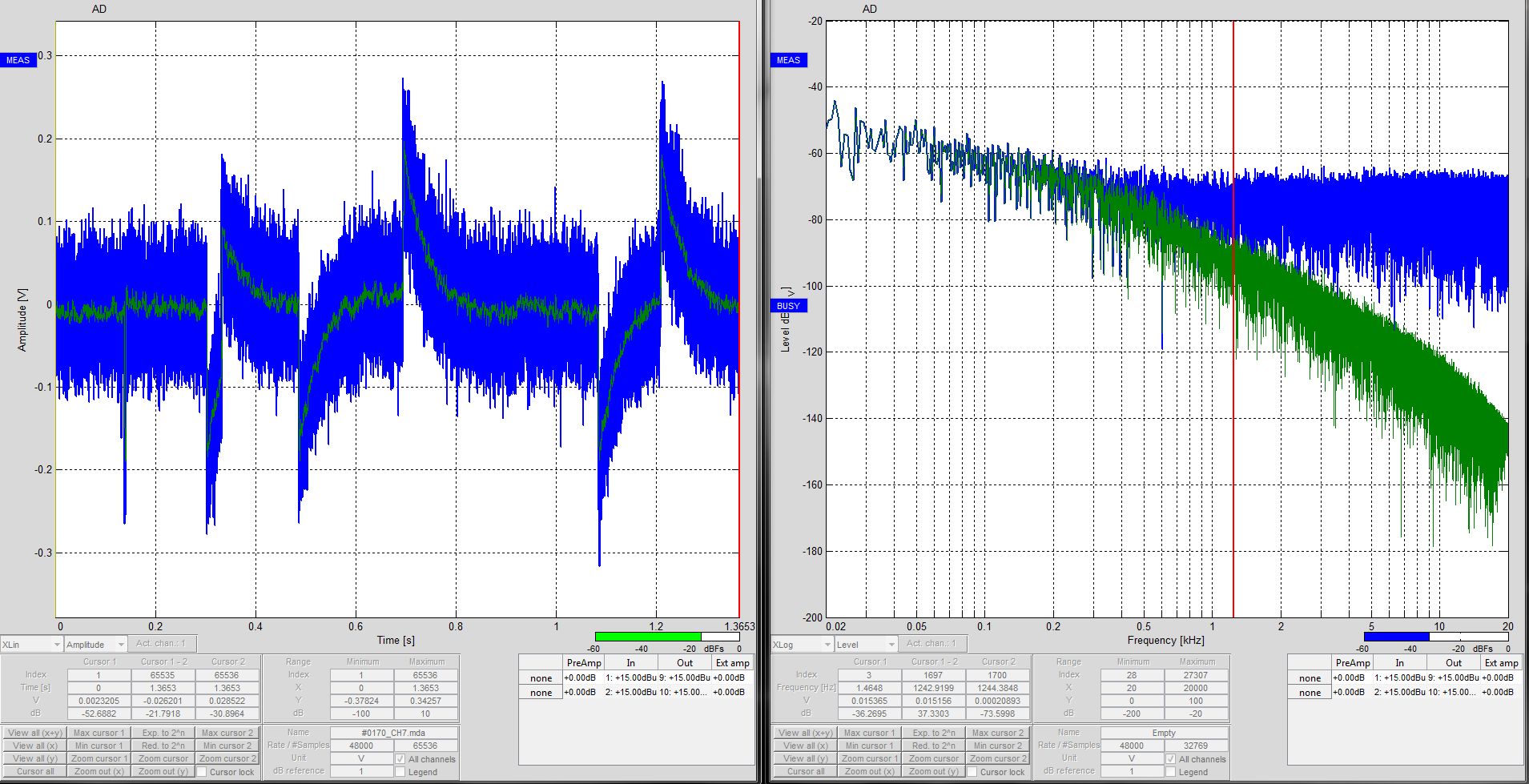

    On one device I changed a PGA which seemed to cause these pop noise. This was in channel 4. The signal which was recorded digitally looked like the picture below. The blue signal is recorded without any filters, green is the same signal but with LPF applied and some gain corrections.

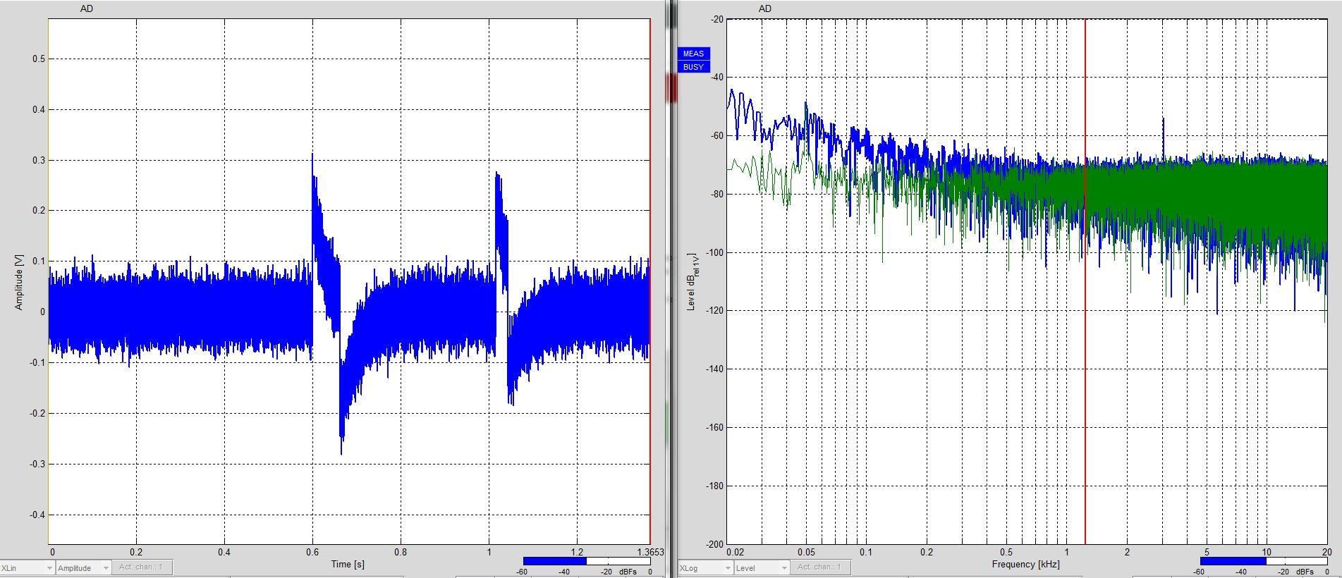

    I changed the PGA. After this I had following picture. Now channel 3 is blue, channel 4 ist green. Both signals recorded without any filters. I'd be glad if you could explain me what happened here...
    Even if not visible in the pictures the time base of both time domain signals is the same.
    Removed protection diodes in ch 4: no different (as expected). Then removed Diodes on Ch 3 also no different.
    I fitted the defective channel 4 PGA into another device and found a disturbance here as well although it looks different here. (Input stage uses the same components like the other device)
    Maybe we should mail you the defective PGA?
    Anyway it looks like there is not only the PGA affected. Possibly the diodes or something else has influence to magnitude and duration of the disturbance.
