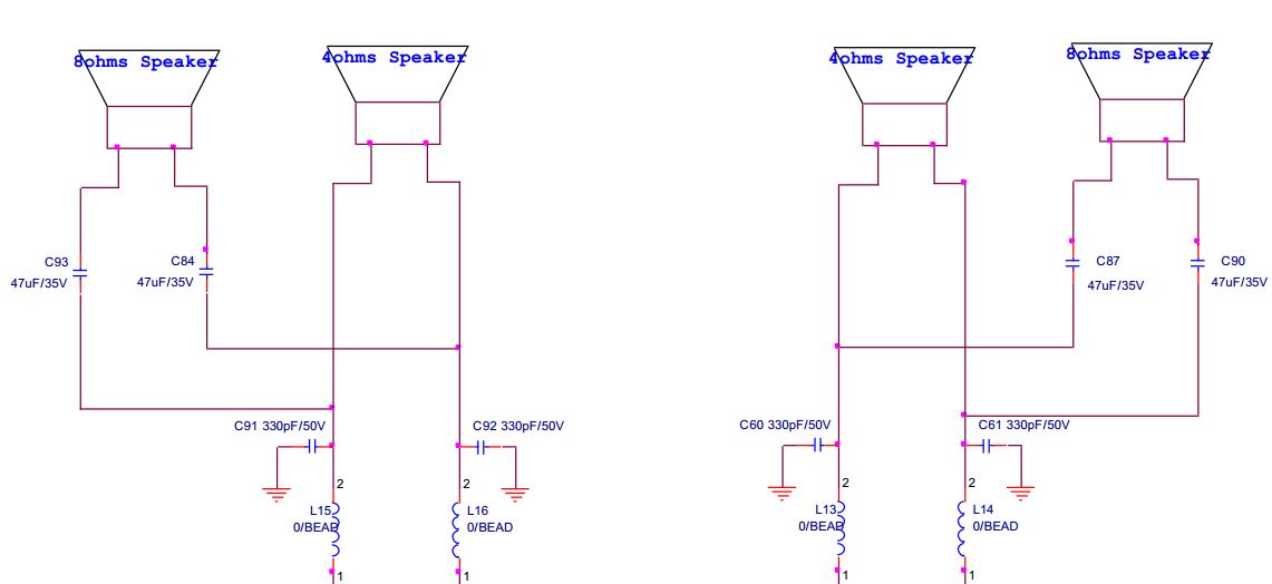

    Cusotmer would like to drive four speaker throung one TPA3136.
    left side has two parallel speaker 4ohm(2W) and 8ohm1W.
    right side has two parallel speaker 4ohm(2W) and 8ohm(1W).
    The the driving load at left and right side is 2.6ohm. According to the spec, it cannot support.
    However, can I confirm with you if customer uses this case that TPA3136 is able to drive 2.6ohm load or not?
    Thansk,
    SHH
  • Hi Alex,
    Here is the idea from custom for the four speaker. Any solution if TPA3136 cannot  support the Rload 2.6ohm?
    SHH

    3. Here is the idea from custom for the four speaker. Any solution if TPA3136 cannot  support the Rload 2.6ohm? - The output power is 3W(2W+1W) on 2.67Ohm(8Ohm//4Ohm) load on each channel. So the maximum output current is 1.5A. The over-current threshold on TPA3136D2 is around 2.5A with 5V power supply. The maximum current is still far away from the OC THR, then it's a safe application.

  • Hi Shawn,
    Thanks for help.
    for quesitons 1, what is the THD under 5V/4ohm/2Watt?
    for questions 3, can you confirm ther is no side effect if customer use 4ohm and 8ohm parrallel?
    from the datasheet, there is the Rload mix support value. 3.2ohm under BTL and PVDD <12V.
    from previous TAS5729 experience, there will be some waveform discuntinuty if Rload is smaller than the min load.
    Thansk,
    SHH
  • Hi SHH,
    The THD performance for 2W is very similar to 1W.
    About 'side effect', could you please help to explain more? Some custoemers have ever used 8Ohm//4Ohm load previously, and we didn't find problem.
    Yes, in datasheet, the minimal load is 3.2Ohm with PVCC<12V. Becasue we need to make sure there is no OC FAULT for a high output power. But in your application, the output power is very low(3W). As the above calculation, the maximum output current is still far away from the OC THR.
    For more questions or issues, you can also send me email.
    Thanks and best regards,
    Shawn Zheng
  • Hi Shawn,
    Thanks for explain. It is clear for question 3. Previous TAS5729 trrigger the OC under the higher power and lower Rload case. As you said, it is different than this 3W case.
    For customer case, what is the THD for parrllel 4ohm(2W) and 8ohm(1W) ?
    For C90/C93/C84/C87, is that ok to put on the twitter speaker trace directly?
    SHH
  • Hi SHH,
    Please see my answers below.
    For customer case, what is the THD for parrllel 4ohm(2W) and 8ohm(1W) ? - THD is around 0.1% with PVCC=5V and Load=2.7Ohm.
    For C90/C93/C84/C87, is that ok to put on the twitter speaker trace directly? - Tweeter speakers only response the high frequency components. The serial capacitor and resistor on tweeter speakers form a HPF, and the crossover frequency is 0.159/(C*R).
    Shawn Zheng
