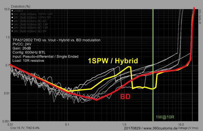

we came across some performance issues while testing 2 new amplifiers based on TPA3128D2 when running in a single-ended (pseudo-differential) input configuration as this is pretty much standard for consumers.
The board is configured as follows:
PVCC: 24V isolated linear bench power supply 150W
Gain: 26dB
Input-Config: Pseudo-Differential
fSW: 600kHz
Modulation: 1SPW aka "Hybrid"
Load: 5R/10R resistive
Config: 2xBTL
Measurement setup: EMU0202 with -30dB differential attentuator

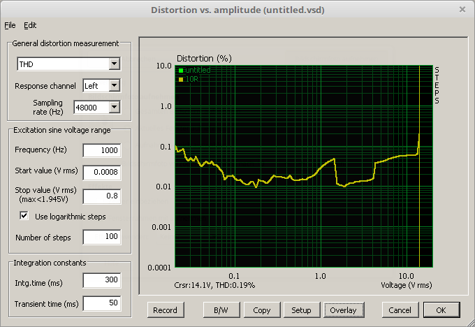

THD Plot:
The modulation changes between 1.5Vrms and 4Vrms this can clearly be seen for 10R load. Is this to give better specs in the datasheet?
Changing modulation to BD is a game changer but still not the optimum.

When we change the input configuration from pseudo-differential to fully-differential, the plot is pretty much spot on the datasheet specs:
Why does TI not mention this "poor" performance in pseudo-differential mode in the datasheet? Isn't it like 90% of the consumer products do only single-ended input configurations? Pretty disappointing.

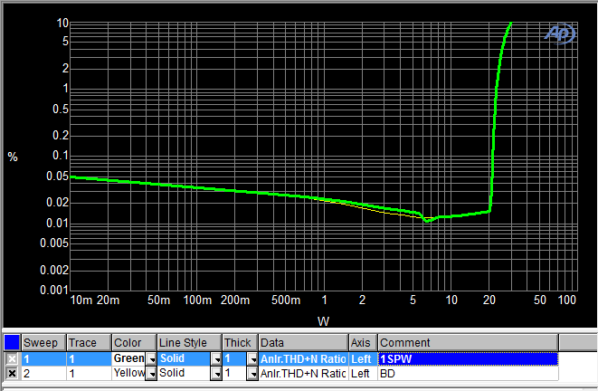

  • Hi Christian,
    THD performance should be close between single-ended input mode and differential input mode. And it should be also close between BD mode and 1SPW mode. The following chart shows the THD performance with single-ended input mode on TPA3128D2 EVM, the green one is for 1SPW mode and the yellow one is for BD mode. PVCC=24V, Load=8Ohm. We can see that the performance is very close between them.
    THe following chart is shown for differential input mode. The performance for 1SPW mode (green one) is also very close to BD mode(yellow one).
    And if you compare single-ended mode to differential mode, the performance is also very close, maybe 0.01~0.02% difference.
    THD measurement is a very sensitive test, please make sure the good GNDing between your board and the instrument. Please also refer to our TPA3128D2 EVM design.

  • Hi Shawn,
    thanks for the plot. Would you mind to tell us the integration parameters and what filters where used? The first plot is quite similar to ours, switching the modulation sheme is between 1.3W-5W but much more damped on your plot. Is this a pure resistive load?
    Well, we did the measurement on 2 different labs miles away from each other on two totally different board layouts with different input/output filters and the result is shown in the first post for pseudo-differential input.

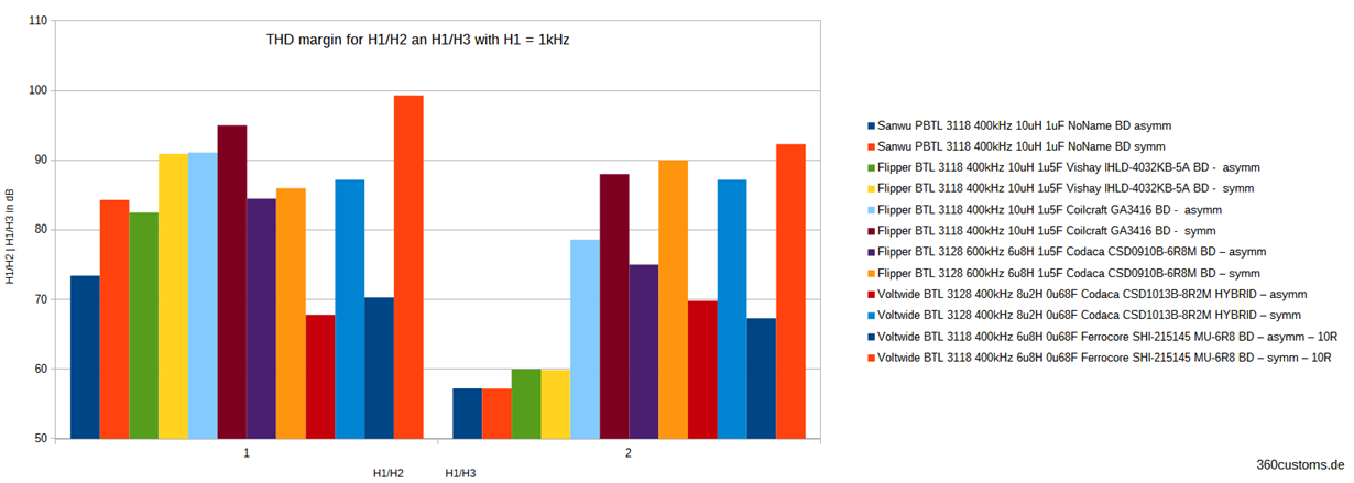

  • Hi all,
    i want to round this topic up, so here are the latest results from our measurements in the other lab.
    Differential vs. Pseudo-Differential in hybrid mode still shows different results:
    The switching in modulation is clearly be seen - increased in THD is due to the use of (Vishay) carbonyl inductors.
    Using different inductors (Codaca CSD0910B) will result in the following plot:
    Comparing both implementations in pure differential drive show that the pcb layout influence, in this case, is negligible.
    All the measurements in a table:
    And a comparison for THD and harmonics margin for differential/pseudo-differential and our pseudo-differential+PFFB approach. THD is measured at 20dBV output level into 5/10R at 1kHz and 400/600kHz.
    Pseudo-differential drive is about 15-20dB behind fully differential - except when using PFFB.
    All the data:
    TPA31xx_2017_09_07.zip
    Conclusion:
    Using the TPA3128 in hybrid modulation + pseudo-differential drive won't give the performance data noted in the data sheet.
    Christian

  • Hi Shawn,
    the 15-20dB difference is measured in Arta "spectrum analyzer" mode at 20dBV output level into 5R or 10R (20W/10W) at PVCC=24V as shown in the table i attached within the .zip file.
    f: 1kHz
    fs: 44k1/48k
    fft-bin: 16k
    avg: 20x linear
    The flipper board is equipped with: 2u2 16V X7R Soft-Term/Flex AEC-Q200 Murata GCJ21BR71C225KA13.
    Christian

    Christian
  • Edit:
    I added another DUT to the comparison which isn't made by us but it widely available on the market. The difference between pseudo-differential/fully differential is also be seen with the older TPA3118.
    So this DUT is a TPA3118 in PBTL with NoName 10uH (undersized) inductors.
    What can be seen from the diagram? For small inductors which suffer from core saturation effects like the NoName and Vishay Carbonyl, the difference between PD (pseudo-differential) and FD (fully-differential) is dominant for H1/H2 (1kHz/2kHz). H1/H3 is bad for
    both, PD and FD. Using inductors from different material and bigger construction, the difference for PD and FD can also be seen for H1/H3.
    If everyone is fine with that we may come to an end. :-)
    Christian
