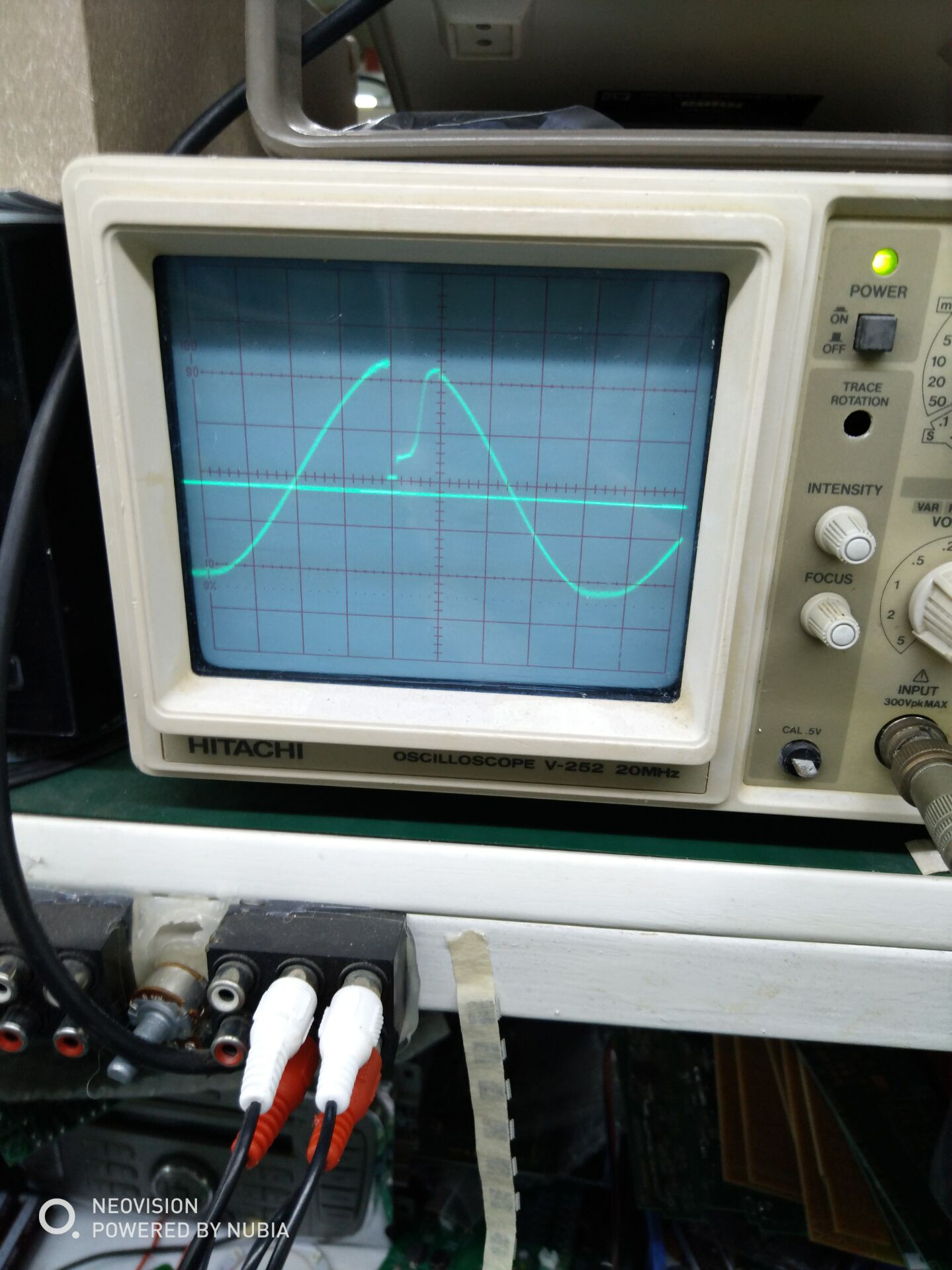

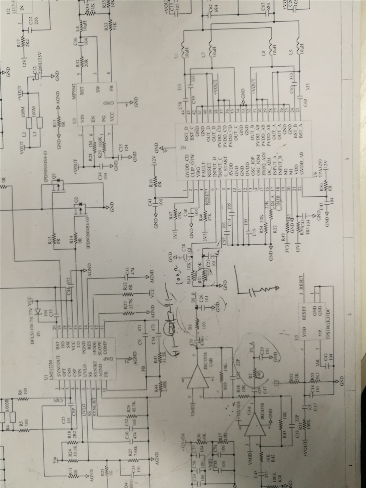

My product used TPA3251, PBTL output, power supply, 34V, load is 4 ohm, it has mass production, but it was found output issue, 1 pcs. will be found about each 100 pcs. it is ok when the board was changed new device.
What's the reason?
