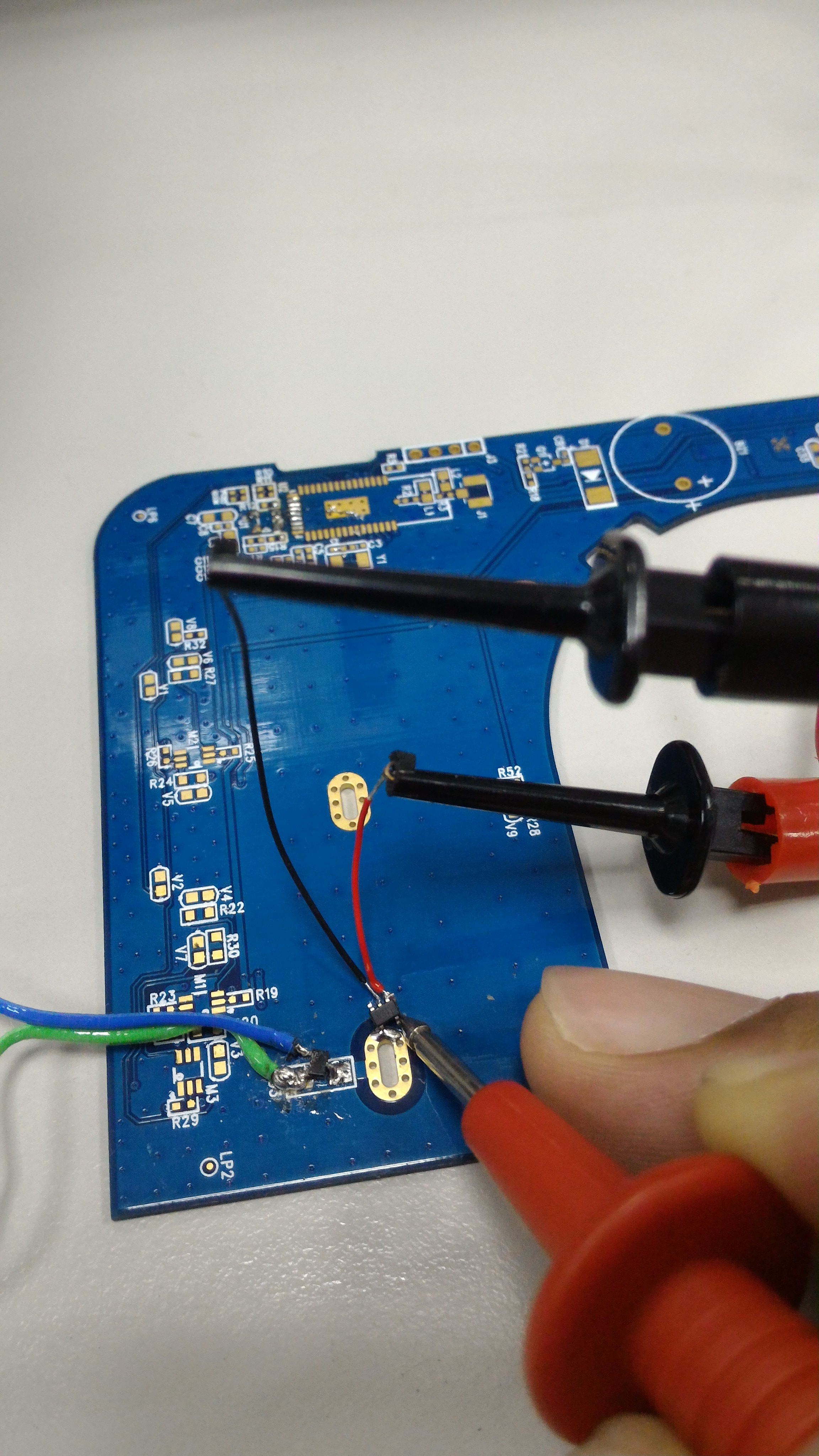

I have a question about measure TLV333 leakage status.  I don't sure the way is correct or not.
Input 2.5V DC voltage at pin1(+IN) and measure pin5(V+) status as below.
I got 1.8V at pin5(V+) as below. Is it leakage issue?

  • Hi Hugo,
    What are you trying to do?  This seems like a strange test to perform.
    Is the V+ pin floating?  If so, then what you're seeing is the IN+ pin positive ESD cell conducting and as a result you're getting +2.5V minus a diode drop at the V+ pin (+2.5V - 0.7V = 1.8V).
