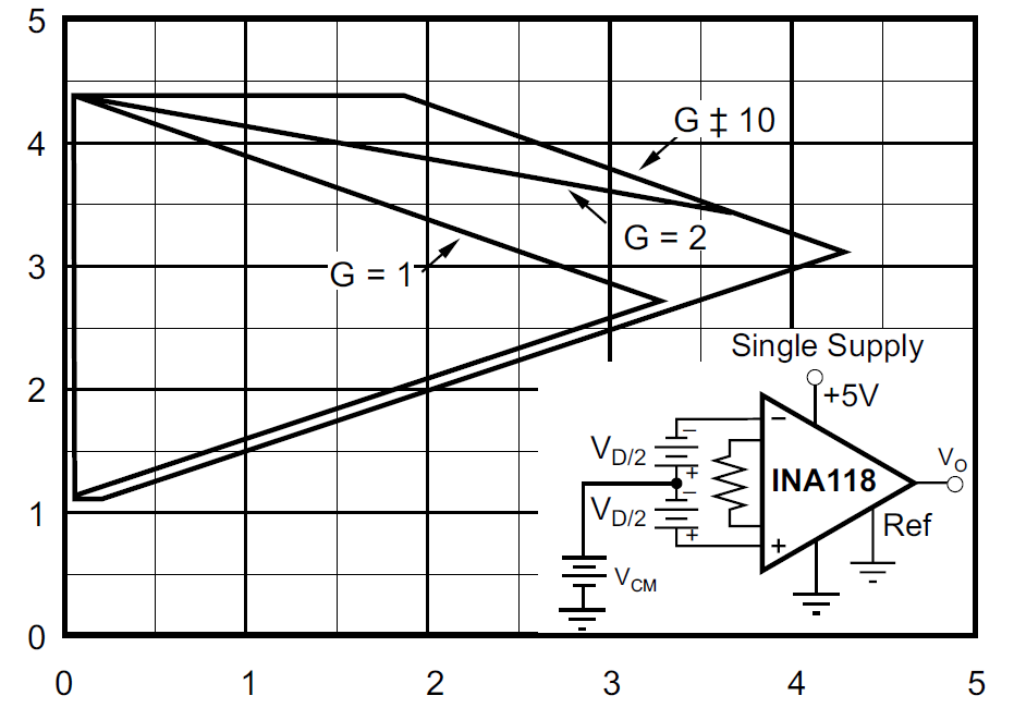

But while looking at the Common mode range graph in the datasheet, I am confused with common mode range.
Because our output range will be 2.5 to 2.8 volts and Common mode range will be 2.25 volts.Hence i am not within the operating graph any more.
I am good with the linear range spec but i am off in the Common mode range when i consider the graph
Which one should i follow either data sheet spec or Graph ???

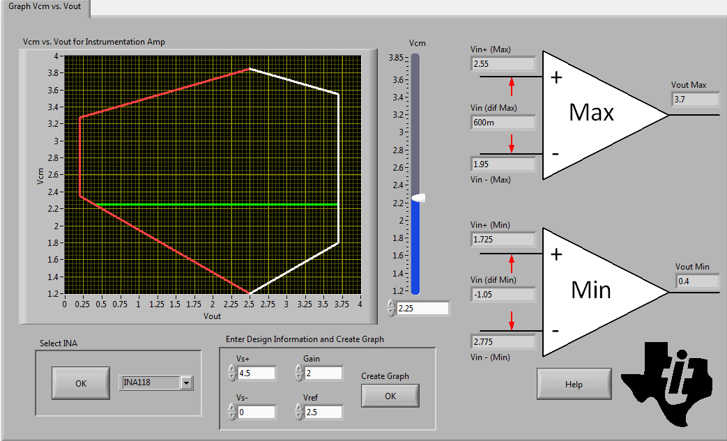

  • Rajesh,
    The Input Common-Mode Range vs Output Voltage graph you show above applies only in the case of Vref=GND.  Since you reference the output voltage to Vref=2.5V instead of negative supply shown on the graph, the applicable Vcm vs Vout graph is different as shown below:
    Therefore, with the input common-mode voltage of Vcm=2.25V and Vref=2.5V, your valid output voltage range is from 0.4V to 3.7V as shown above; thus for the input voltage of Vin=2.25V +/- 0.100V, INA118 can easily accomodete for G=2 your expected output voltage range from 2.1V to 2.9V
